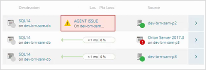

Troubleshoot agent-related issues for application dependencies in SAM
If you suspect agent issues are interfering with Application Dependencies or Connection Quality polling, here are some items to check:
