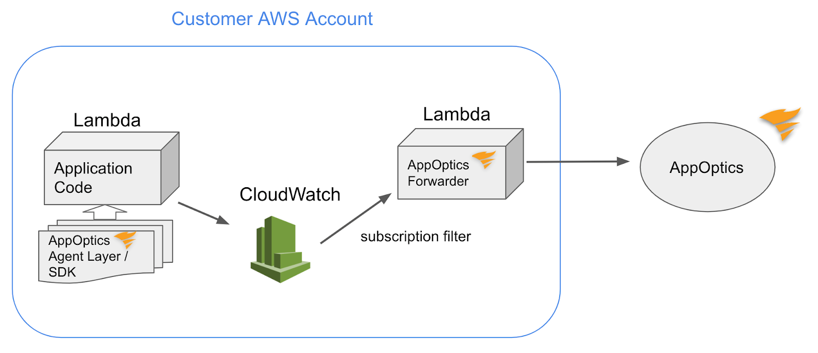

AppOptics Lambda Forwarder
The forwarder is provided as a Serverless Application Repository application named AppOptics-Lambda-Forwarder. Once installed as a Lambda function in your account, it is invoked by the CloudWatch Logs subscription filter(s) that you configure on the log group of your Lambda function. The forwarder ingests these log events to report enhanced metrics for your function; if tracing is enabled for your Lambda function, the forwarder also transforms the trace data found in the log events and reports them to AppOptics.

Tracing
In the AWS Lambda environment, APM agents work by writing trace data to your function’s CloudWatch Logs log group. In order for the logged trace data to be transformed and reported to AppOptics, the AppOptics Lambda forwarder needs to be installed and properly configured, and a subscription filter needs to be configured for your Lambda function. Ensure that these prerequisites are met before proceeding with instrumenting your function.
You may incur additional cost in AWS by enabling the Forwarder and APM agents.
When the agent is enabled and running in your Lambda function, you should see the trace data in CloudWatch Logs entries with the format below:
