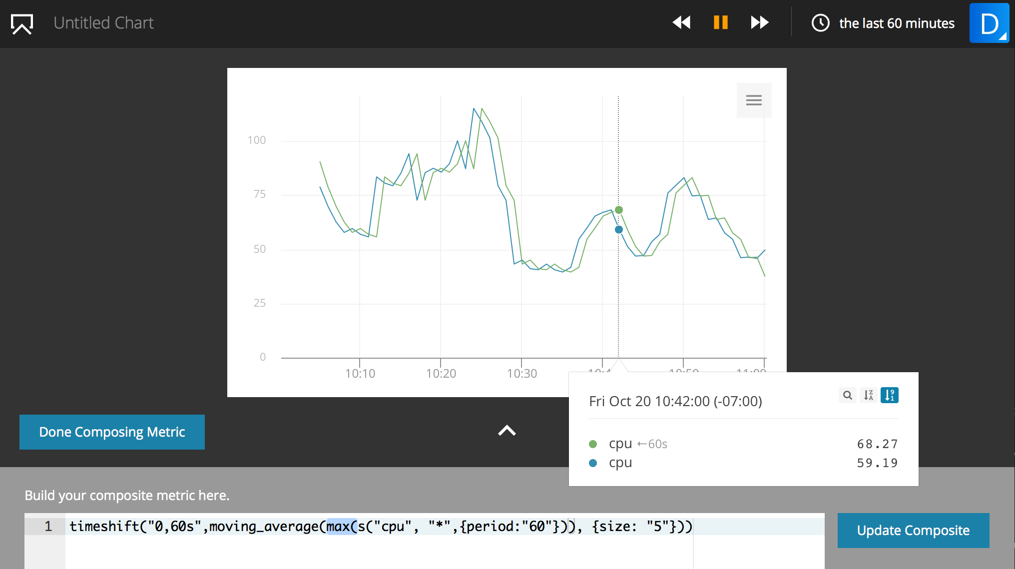

This example shows how to create a graph with two lines timeshifted by one minute.
timeshift("0,60s",moving_average(max(s("cpu", "*",{period:"60"})), {size: "5"}))
