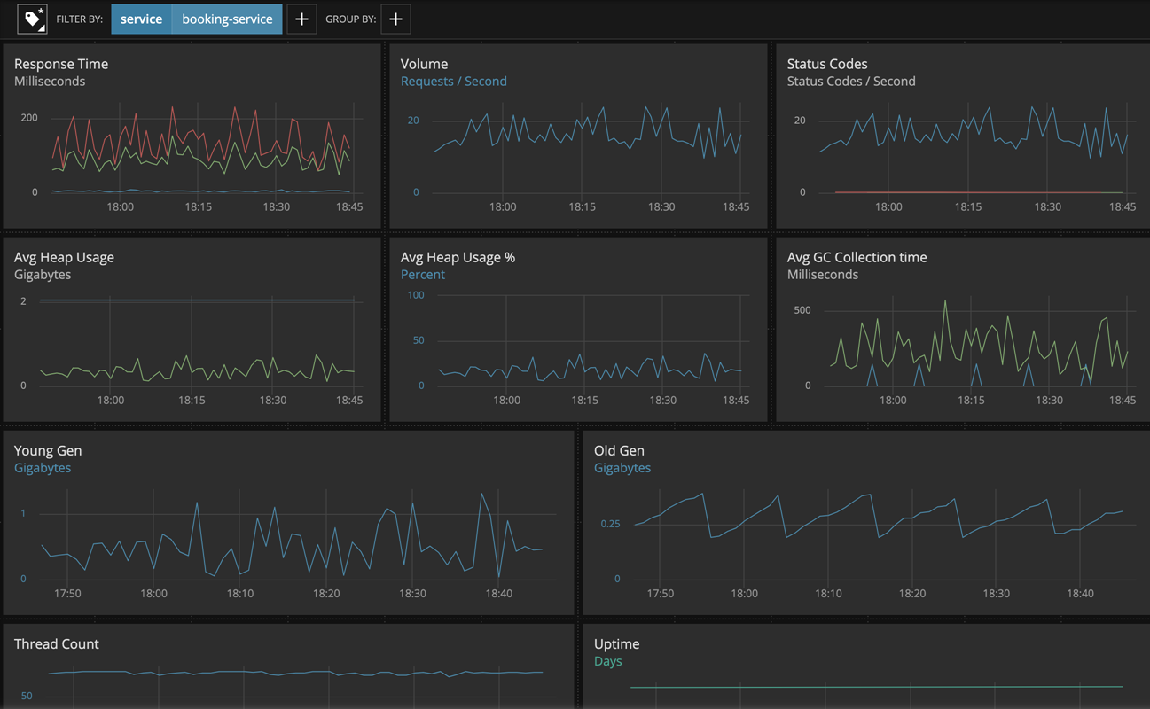

Runtime Metrics
Many of our agents also report language-specific runtime metrics, to provide you insight and monitoring on memory, CPU and other statistics about your application's execution environment. An example is using the JMX metrics reported by the Java agent to correlate between application performance and JVM metrics such as garbage collection, heap size, and thread count.
The agents report runtime metrics out-of-the-box; on detecting these metrics, AppOptics automatically creates a pre-configured dashboard in your account to help you easily monitor key metrics right away:
These runtime metrics are also available throughout the AppOptics system for you to use in custom charts and dashboards and alerts.
