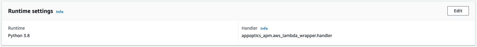

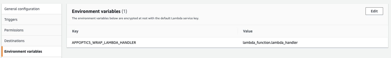

Regardless of the configuration option you choose, after successfully enabling instrumentation of the Lambda function, the function settings should look similar to the AWS Console shown in the image below, in this case for the function handler lambda_function.lambda_handler.

  1. Set the environment variable APPOPTICS_WRAP_LAMBDA_HANDLER to the function’s configured “Handler” setting.
  2. Change “Handler” setting to appoptics_apm.aws_lambda_wrapper.handler
