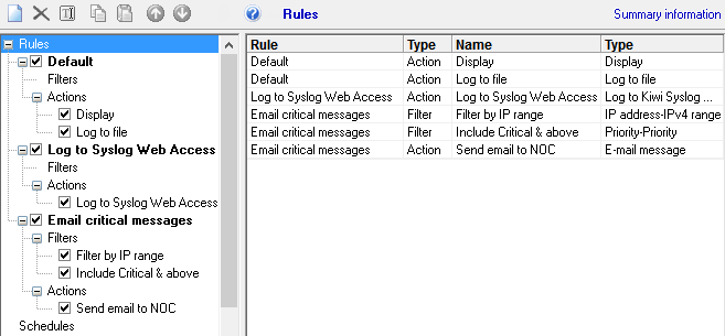

  1. Choose File > Setup to open the legacy KSS Setup dialog box.
    The left pane displays existing rules.

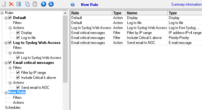

  2. Right-click Rules and choose Add Rule.
    A new rule is added below the existing rules.
  3. Replace the default name with a descriptive name.
