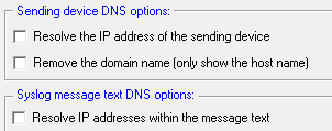

3. Clear the options in the KSS DNS Resolution settings to resolve IP addresses
  1. In the legacy KSS Setup dialog, click DNS Resolution.
  2. Clear both options to resolve IP addresses.

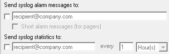

4. Clear the options in KSS E-mail settings to send alarm messages and statistics
  1. In the legacy KSS Setup dialog, click E-mail.
  2. Clear Send syslog alarm messages and Send syslog statistics.
