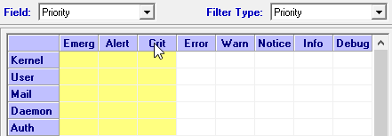

  5. In the Field menu, select Priority.
  6. Select a cell or column header. Selected cells are highlighted.
  7. Right-click the highlighted area and select Toggle to On.

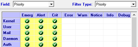

    Green check marks indicate the column cells included in the Priority field.
  8. Test the filter.
  9. Click Apply.
Only messages with the priorities you select trigger the actions in the associated rule.
