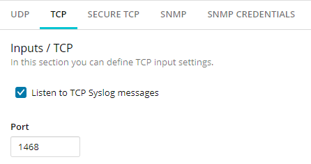

If the device is sending TCP messages or SNMP traps, verify that KSS NG is configured to listen for that protocol on the designated port
  1. In the navigation bar, select Setup > Settings and click the Inputs tab.
  2. Click the corresponding tab of the protocol that the device uses.
  3. Verify that Listen is selected, and verify the port number and other options for that protocol.
In addition, verify that no other service is using the required port by following the example, but substituting the appropriate port number and protocol.

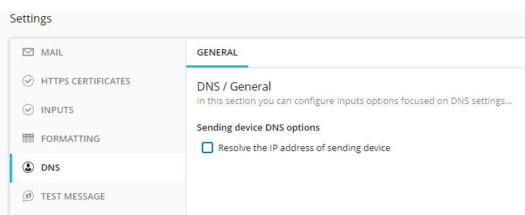

Clear the options in the KSS NG DNS settings to resolve IP addresses
  1. In the KSS NG navigation bar, choose Setup > Settings and select the DNS tab.
  2. Uncheck the options to resolve IP addresses.
