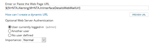

  6. Click Edit for the E-Mail a Web page action.
  7. Enter an Email address for receiving the web page. You can specify the sender and a reply address.
  8. Expand Message.
  9. In the Enter or Paste the Web macro, enter the macro:
    • For incoming traffic: ${N=NTA.Alerting;M=NTA.InInterfaceDetailsLink}
    • For outgoing traffic: ${N=NTA.Alerting;M=NTA.OutInterfaceDetailsLink}
  10. Complete the Edit Alert wizard.

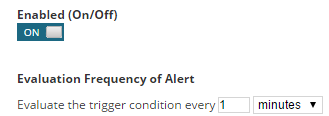

  5. Adjust the alert properties if necessary. Under Enabled, turn the alert On and select how often the trigger condition should be checked.

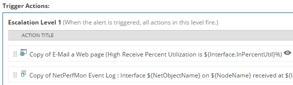

  9. On Trigger Actions, create actions to execute when the alert triggers.
    If there are endpoint-centric widgets on the Interface Details page when it is captured for a top talker alert notification, the links to those widgets will be non-functional in the email. The information in the alert notification is not customizable.

  4. Adjust the alert properties if necessary. Under Enabled, turn the alert On and select how often the trigger condition should be evaluated.

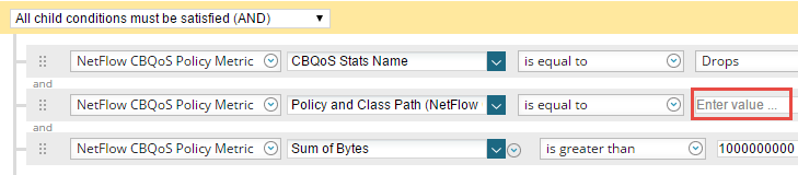

  5. On Trigger Condition, define the conditions that trigger the alert.
    Go to the fourth field in the Policy and Class Path line, press the down key, and select a policy.
    Tips
    • If the class name is unique, select "includes" in the third box for Policy and Class Path, and type a unique part of the class name into the last box.
    • To be alerted on all policies (Drops, Pre-Policy, or Post-Policy, based on the selection in the CBQoS Stats Name line) that exceed the specified sum of bytes, delete the Policy and Class Path line from the trigger condition.
    • To be alerted on policies on a node, add a simple condition defining the node name. Select Node as the SolarWinds Platform Object in the first field, and Node Name as the Database column. See Define the conditions that must exist to trigger an alert in the SolarWinds Platform online help.

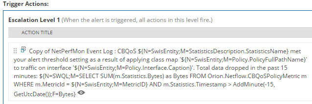

  9. On Trigger Actions, create actions to execute when the software triggers the alert.
    The default action for all alerts is to write to the SolarWinds event log.
