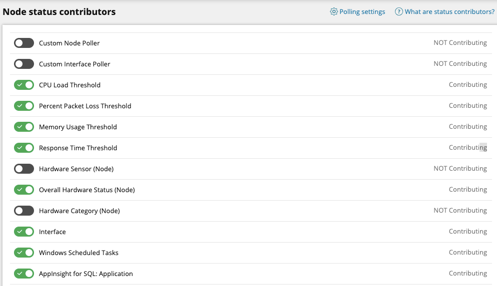

Starting with Orion Platform 2019.2, you can keep using this "classic" method for calculating node status, or switch to the "enhanced" node status calculation where you can select what "contributors" are reflected in the status. A contributor is a status of a metric or feature that can influence the node status, such as the status of an interface, a hardware health sensor, or even a threshold.
Based on your settings, the following items might be reflected in node status:
- Node thresholds: Both global thresholds and thresholds specified for individual nodes are now reflected in the node status.
- Child objects: The status of interfaces, hardware health, or applications monitored on a node is reflected in the node status.

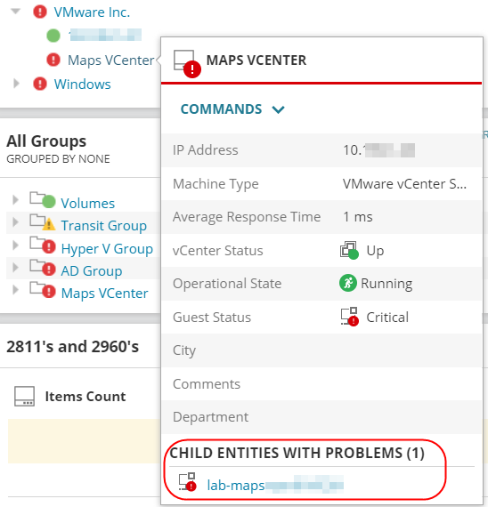

Node tooltips: If you position your cursor over a node in the critical status in any widget, the child entities causing the problem are listed at the bottom of the tooltip.

Specify what should be included in the node status calculation
Including a group contributors, such as interfaces, into the node status calculation means that the node status turns to warning when any of the entities on the node is down.
- Click Settings > All Settings and scroll down to Thresholds & Polling.
- Click Node Child Status Participation.
- Review the list of components that can influence the node status. Available items depend on the SolarWinds Platform products you have installed.
- Enable items to be included in node status calculation.
SolarWinds recommends that you keep the default settings.

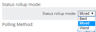

You have now defined the components that influence the node status calculation. Decide how to use them in the status calculation. SolarWinds Platform uses status roll-up mode to set how the partial components of node status should be evaluated.
Worst
The total node status is the worst status among the configured options.
Best
The total node status is the best status among the configured options.
Mixed (default option)
The global node status combines all specified contributors.

Change status rollup mode
By default, the status rollup mode is set to mixed. To change it, edit it in the settings for individual nodes:
- Go to the node details page, or select the node on Manage Nodes.
- Click Edit Node.
- Select the status rollup mode for the node, and submit your changes.
