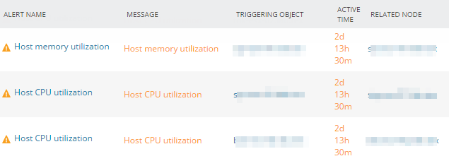

By default, alerts appear in the Active Alerts widgets on the Orion Home page.

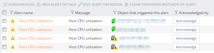

To see all alerts, click the All Active Alerts button in the Active Alerts widget, or go to Alerts & Activity > Alerts. On this page, you can:
  • Acknowledge an alert that you are working on
  • Click on any alert to go to the Alert Details page for more information
  • Click Manage Alerts to enable/disable, add, or edit any alert
