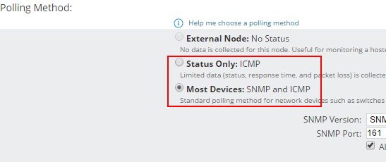

Verify the polling method for the node
- On the node details view for the node, click Edit Node in the Management resource.
- In the Polling Method area, select Most Devices: SNMP and ICMP, provide version, port, and credentials.
- Click Submit.
After two minutes, the node status is Up. After ten minutes, node statistics are updated.

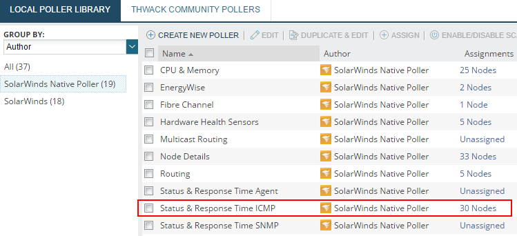

- Click Settings > All Settings > Manage Pollers.
- In the Local Poller Library tab, click SolarWinds Native Poller, and locate the Status & Response Time ICMP poller.
- Click the item in the Assignments column for the poller. A list of nodes where the poller is enabled opens.

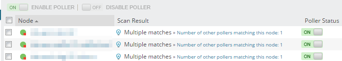

- Search for your node and ensure that the Poller Status is ON.
- If the poller status is OFF, select the node, and click Enable Poller.
