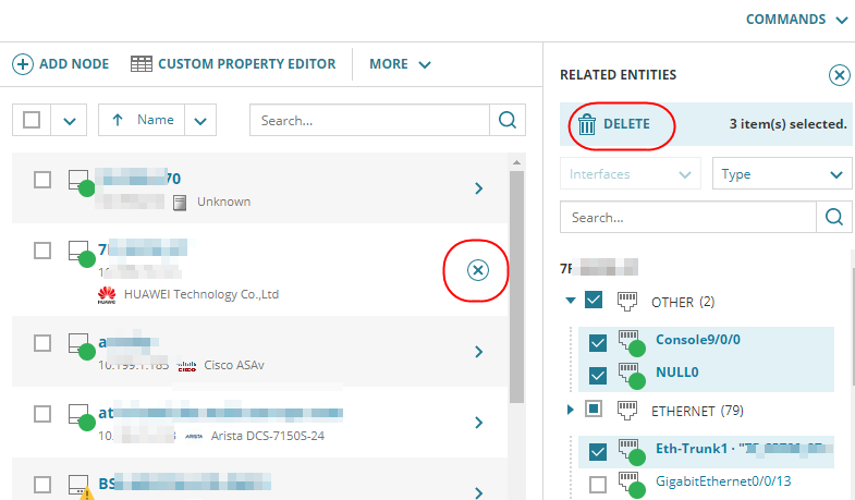

Delete interfaces from Manage Entities page
                                    Click Settings > Manage Nodes. To view interfaces on a node, click the arrow at the end of a row. Interfaces display in the Related Entities pane. To get to Manage Entities from Manage Nodes, click the New Manage Entities page link at the top. To get back to Manage Nodes, click Commands > Switch Back in the top right corner of the page.
                                    Select interfaces to delete, and click Delete. Selected interfaces are deleted immediately. All references to these interfaces are cleared during the database maintenance (by default at 2:15 a.m.).
