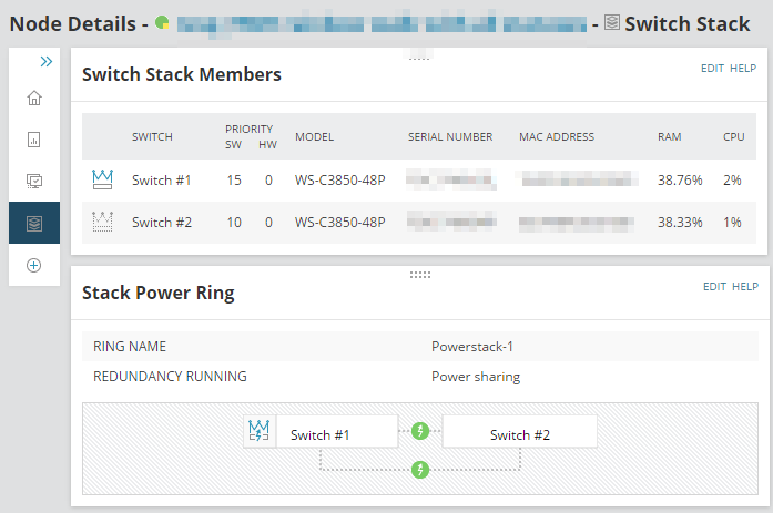

View stack members and rings
When you receive an alert about a switch stack problem, go to the node details page, and click the switch stack subview.
The subview provides member-specific monitoring with topology maps showing how the data ports and power ports are connected, and information to pinpoint switches with issues.
You can quickly see which switch is having issues, locate it by serial number in the stack, and replace it or resolve the issue.

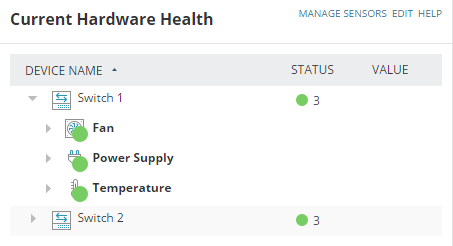

When you are monitoring hardware health on a Cisco switch stack node, you can see the health of individual switches in the stack. The health indicators inform you when the values on a switch are near the safe limits, or when they reach the critical stage.
  1. Log in to the SolarWinds Platform Web Console, and go to the switch stack node details page, and click the Network subview.
  2. Consult the Current Hardware Health resource.
  3. Expand a switch in the stack to display hardware health monitors.
  4. The item in the Status column describes the number of sensors monitored on the switch, grouped by the status of the sensor.
    You can now troubleshoot the switch stack member that is experiencing issues.

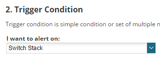

  3. On Trigger Condition, select the SwitchStack item you want to alert on.

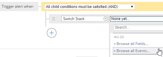

  4. In Trigger alert when, select a condition, click the arrow in the second box next to the selected SwitchStack object, and select Browse all events.

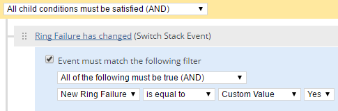

  5. Select the event you want to alert on and if necessary, complete the trigger condition.
    For example, if you want to be notified about a switch stack ring failure, select the Ring Failure event, select Event must match the filter, and then select New Ring Failure is equal to Yes.
