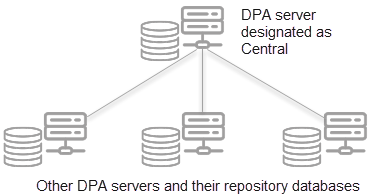

Use Central Server mode to link separate DPA servers together. Examples of why you might want to do this include:
  • The infrastructure resources supporting DPA (for example, storage availability, I/O throughput, RAM, and CPU) reach capacity as the volume of queries being analyzed increases.
  • Your monitored instances are distributed geographically, and the network lag time to distant instances is high. You can install separate DPA servers in each location.
  • You want to enable separate teams or business units to manage their subset of database instances.
The Central Server collects information from your remote servers and consolidates the data into a single interface.
Each DPA server has its own repository. The Central Server has low overhead and no additional information from other DPA installations is added to its repository database.
