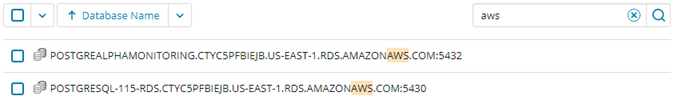

                                            Enter a string in the search field to find database names, subjects, or certificates that include the string. The list is filtered to show only database instances that meet the search criteria.

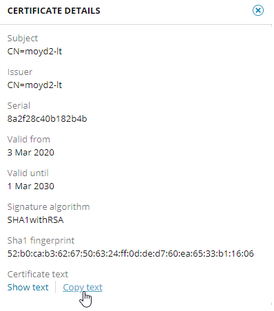

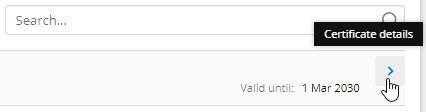

                                            Click the arrow on the right to view certificate details.   The Certificate Details panel opens. Click a link at the bottom to view or copy the certificate text.

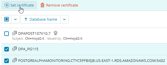

                                    Select the database instances you want to associate with a certificate. The Set certificate and Remove certificate buttons are displayed.

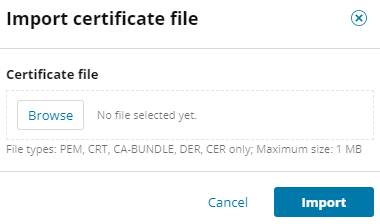

                                    Click Set certificate. The Import certificate file dialog box opens.

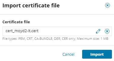

                                    Click Browse and select the certificate file.
                                    Click Import. The certificate is imported and associated with the selected database instances.

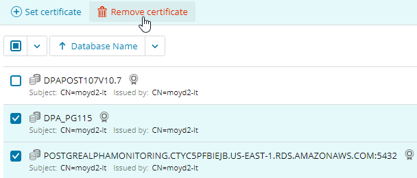

                                    Select the database instances that are associated with certificates you want to remove. The Set certificate and Remove certificate buttons are displayed.
                                    Click Remove certificate, and then click Remove on the confirmation dialog box. The selected database instances no longer have certificates associated with them, and the certificates are removed from the DPA repository database.
