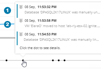

                                    To view annotations or information about VMware events (for instances that run on a VM), hover over a dot on the line above a chart. These events can sometimes explain changes in resource metrics.     VMware events that occurred on the same VM have a blue line beside them.   VMware events that occurred on a different VM running on the same host do not have a line beside them. You can choose which VMware events to display on charts.

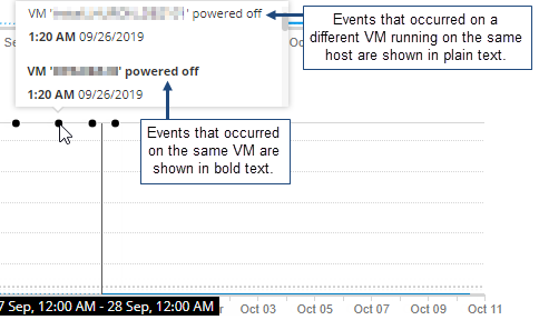

                                    To view information about VMware events that might explain changes in behavior, hover over the blue or gray arrows at the top of a chart. Blue arrows indicate that events occurred on the VM where the database instance runs. Gray arrows indicate that events occurred on other VMs that run on the same host. When you hover over an arrow, events that occurred on other VMs are in shown in plain text. Those that occurred on the same VM are highlighted in bold, blue text. You can choose which VMware events to display on charts.

To view annotations or information about VMware events (for instances that run on a VM), hover over a dot on the line above a chart. These events can sometimes explain changes in resource metrics. VMware events that occurred on other VMs are shown in plain text. Those that occurred on the same VM are shown in bold text.
