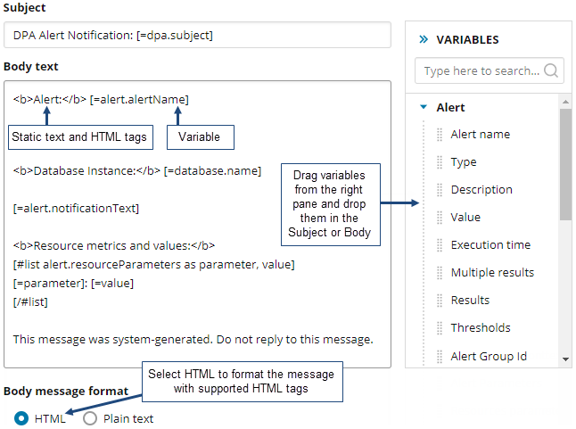

- Enter a unique name and, optionally, a description.
- Specify the content and formatting of email notifications based on this template:- To add content: - Drag and drop variables from the right panel into the Subject line or body (or type the variables). These variables represent information about the triggered alert or links to additional information in DPA. For information about the available variables, see Email template variables.
- Type static text into the Subject line or body.
- To remove content, delete variables or static text from the Subject line or body.
- To format body text with bold, italics, or line breaks: - Under Body message format, select HTML. - If Plain text is selected, any HTML tags are treated as text and shown in the alert notification email.
- Enter the following tags to format the body text: - <b> </b>- <i> </i>- <br>or- <br />- All other tags are unsupported. You cannot save a template that contains unsupported tags.
- Click Save to save your changes and close the page.
                                    Apply the email template to alerts in either of the following ways: - To apply the template to a specific alert, edit the alert definition and select the template from the Email Template drop-down menu.
- To apply the template to all alerts that use the default email template, specify this template as the default.

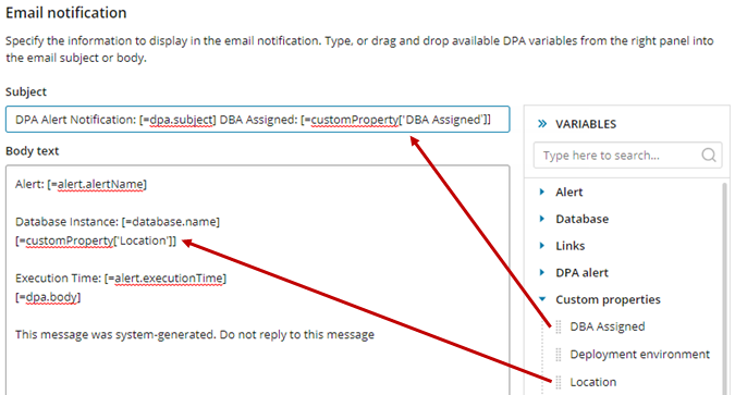

Custom properties
In addition to the predefined variables listed above, you can create custom properties to include other information in alert notification email templates. If any custom properties have been created for this DPA server, they are displayed in the Custom properties section in the Variables list.
The following example includes the custom properties DBA Assigned and Location. All DBAs receive these email notifications, but the DBAs can set up rules to process them. For example, a DBA named Bill Smith has a rule to delete DPA alert notifications if the Subject does not contain DBA Assigned: Bill Smith. If the Subject does contain that string, he has another rule to flag the email as important.
