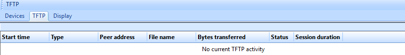

The TFTP pane enables you to view messages originating from the KCT NG TFTP server. You can also stop or start the TFTP server from this tab.
Option Description
Start
Starts the TFTP server, if it is not already started.
Stop
Stops the TFTP server if it is running.
Clear TFTP
Clears the display of TFTP server messages.
