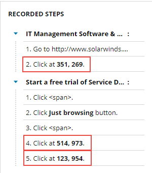

- Click Play and verify that the recorded clicks and actions appear in the Recorded Steps pane.
