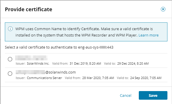

You can use the Web Transaction Recorder to create recordings that check for valid client certificates. When you record a sequence of steps that navigates to a page with a certificate, you're prompted to select a certificate for that step.
When you select a certificate, WPM stores the following data in an authentication binding that is saved within the recording:
- The URL for the secured page (or portion) and,
- The Common Name (CN) property of the certificate.
