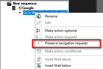

The Deprecated WPM Recorder can't count duration time on web pages with automated redirects
If a transaction recorded in the Deprecated WPM Recorder involves navigating to a web page that includes an automatic redirect to another page, the time spent navigating to the first web page may not be included in calculated in the overall duration time.
To capture accurate durations when creating a recording that involves navigating to web pages that redirect to another web page:
- For the step that redirects to another web page, right-click and select Preserve navigation request from the shortcut menu.
- When prompted to verify that you want to preserve navigation requests, click Yes.
If you enable this option, navigation may take longer to complete than it would if this option was disabled.

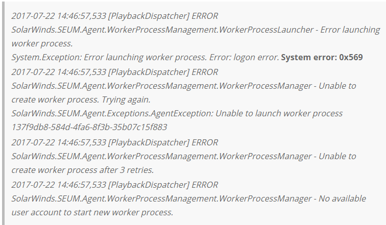

Tips to troubleshoot WPM Player issues that begin after an upgrade
Here are examples of issues you may encounter after upgrading WPM:
- Transactions assigned to a WPM Player location switch to Unknown status.
- The SolarWinds WPM Playback Player service enters a retry loop when attempting to spawn a new WPM worker process. Each attempt is cited in

A log entry similar to this one appears in the AgentWorker logs:
The WPM Player cannot play the transaction because the WPM Player service account used for playback does not have permission for required resources, including logging in to the local system.
To resolve this issue, add all WPM Player service accounts to the local Administrators group on the WPM Player server.

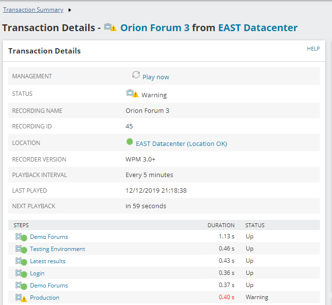

- If you encounter WPM transaction steps with a Not played yet status on the Transaction Details page, this may be related to domain policy access rights to the WPM Player, or incorrect passwords for user accounts in configuration files. See this article in the SolarWinds Success Center.

WPM transactions fail to play — ERROR LOGON TYPE NOT GRANTED - Logon Failure
To support playback, WPM worker processes play steps of transaction recordings, collect statistics and screenshots, and return playback results to the WPM Player. If the WPM Playback Player service cannot start WPM worker processes, you may receive the following message:
ERROR_LOGON_TYPE_NOT_GRANTED - Logon failure: the user has not been granted the requested logon type at this computer.
This message may appear if a security policy was changed to limit "log on locally" permissions.
- Verify that the WPM Player service account has permission to log on locally.
- If necessary, change limitations for user accounts.
The WPM Playback Player service should run as Local System, not under a specific user account.

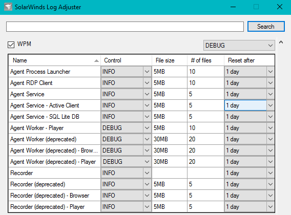

C:\ProgramData\Solarwinds\Logs\SEUM - On Windows systems, run the SolarWinds Log Adjuster. Click Start > SolarWinds Orion > Log Adjuster, and then scroll to the WPM section.
- For a transaction based on a recording created in the new Web Transaction Recorder, enable VERBOSE for these rows:
- Agent Worker - Browser
- Agent Worker - Player
- For a transaction based on a recording created in the Deprecated WPM Recorder, enable DEBUG for these rows:
- Agent Worker (deprecated)
- Agent Worker (deprecated) - Browser
- Agent Worker (deprecated) - Player

- To avoid disk space issues, return to the SolarWinds Log Adjuster to turn off DEBUG. Click Reset to default > Apply.

- In the SolarWinds Platform Web Console, navigate to the Transaction Details view, take a screenshot of the Transaction Details widget, and save it to a PDF file.
- Submit a SolarWinds Support ticket that includes a ZIP file with the following items:
- WPM diagnostic logs
- The recording you are having trouble with.
- Credentials used for the recording, if applicable.
- A screenshot of the Transaction Details widget.
Skip any files currently in use by WPM, if prompted.

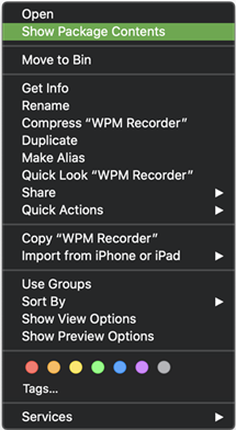

Locate Web Transaction Recorder log files on macOS systems
To find Web Transaction Recorder log files on a macOS system:
- In the Finder window, navigate to the Applications location
- Right-click the WPM Recorder icon to open its context menu.
- Click Show Package Contents.

Adjust log settings to troubleshoot Image Match actions
This section includes tips for troubleshooting specific WPM issues, such as Image Matching in recordings.
For issues related to Image Match actions recorded in the Web Transaction Recorder:
- Enable VERBOSE logs for the following rows in the SolarWinds Platform Log Adjuster:
- Recorder
