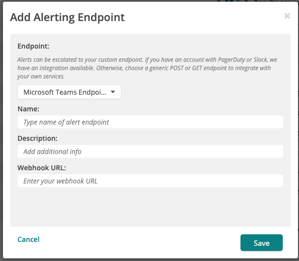

  1. In the Loggly the navigation menu click Alerts > Alerts Endpoint, and the click Create Endpoint.
  2. Select Microsoft Teams Endpoint from the Endpoint drop-down menu.
  3. Enter a Name and Description for the endpoint in the corresponding fields.
  4. Enter the Webhook URL (from Step 1 above) in the field provided.
This new alert endpoint is now available as an option when you create Loggly alerts.

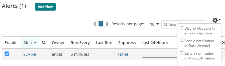

Enable Room Notifications for Teams
Click the gear icon and check Send a notification in Microsoft Teams. After enabling this, channel members will be notified of new Loggly alerts.

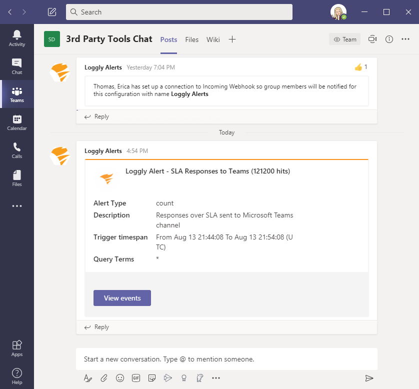

Verify that Your Alerts are reaching your Teams Channel
Generate some logs that trigger your alert. Wait a few minutes for the alert to run, then check your Teams channel for the messages.
