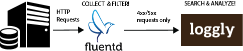

The following article describes how to implement a unified logging system for your Docker containers and then send them to Loggly via the open source log collector Fluentd. Fluentd has a variety of filters and parsers that allow you to pre-process logs locally before sending them to Loggly.

Step 2: Set up Fluentd to send logs to Loggly
Once you have the Fluentd logging set up as described above on the Docker container, you can then follow the link below to see the instructions to send the logs to Loggly. We recommend tagging the logs that are coming from your container via Fluentd to include a tag such as ‘docker’ in order to easily locate your Docker logs in Loggly’s Dynamic Field Explorer.
https://www.loggly.com/docs/fluentd-logs/
fluentd-loggly-blog
