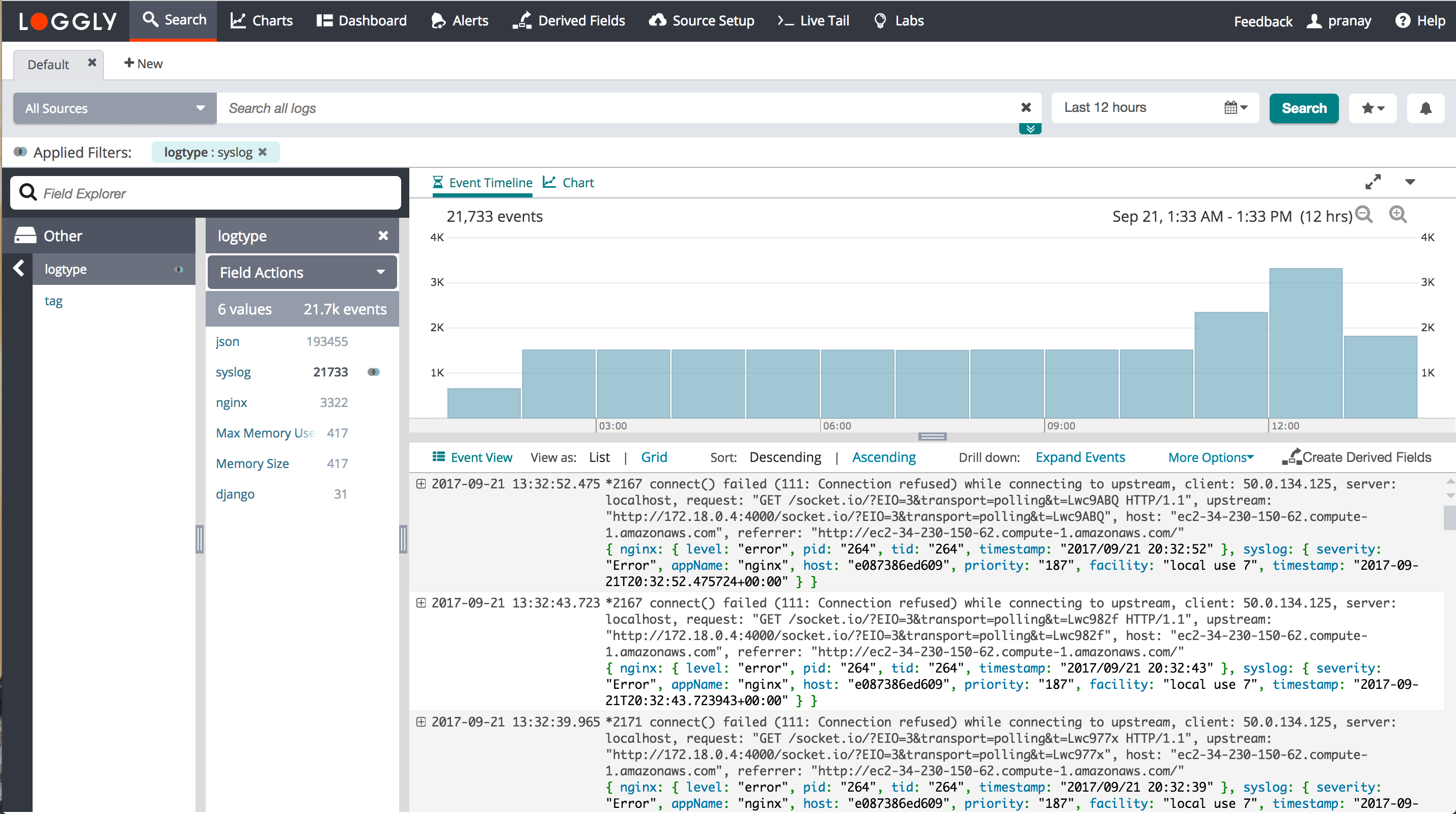

Search Loggly over the past 30 minutes to find your logs. It may take a few minutes to index them. If you don’t see them, check the troubleshooting section below.
Click on one of the Linux logs to show a list of syslog fields. If you don’t see them, please check that you are using one of our automatically parsed formats.
