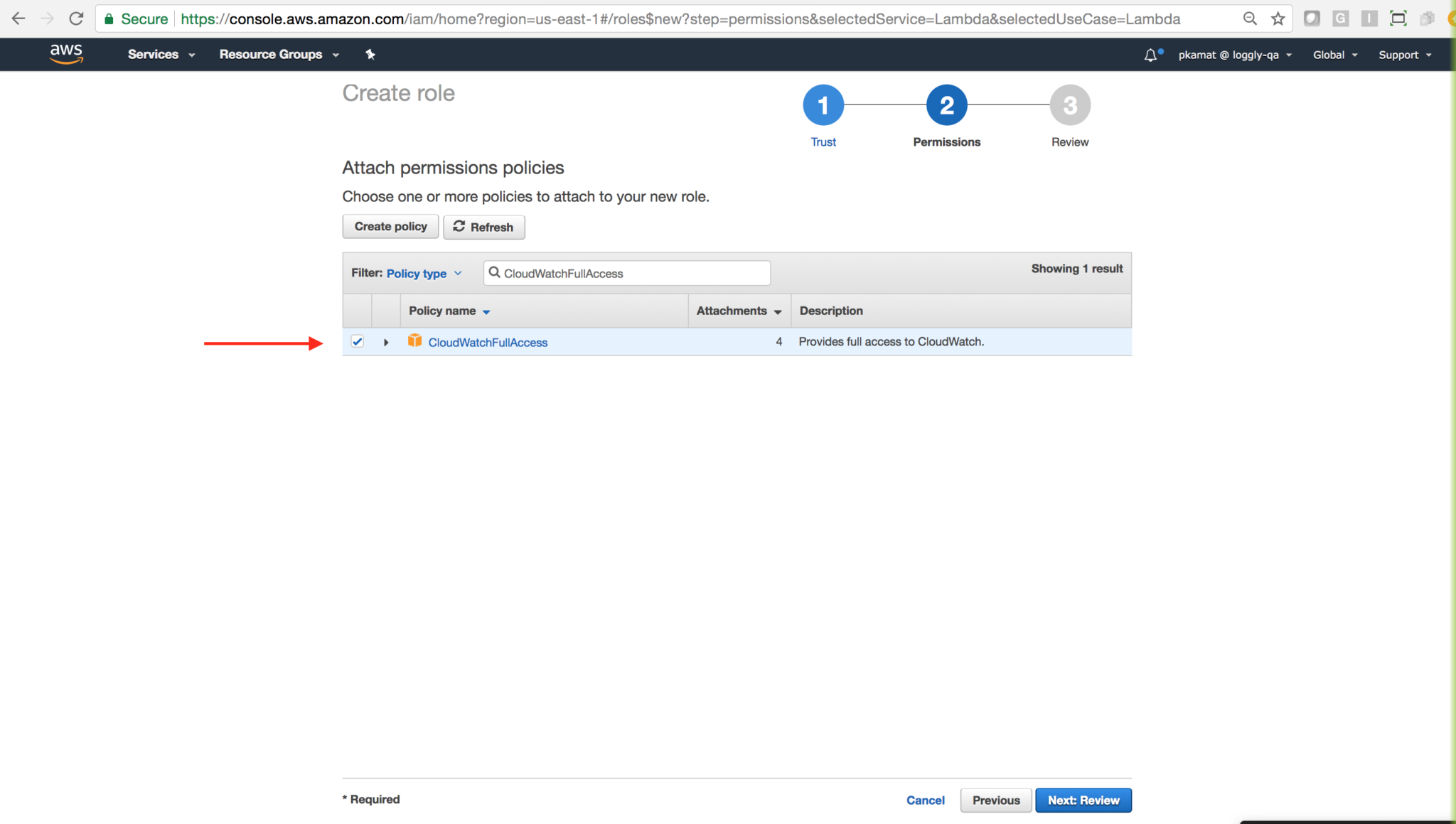

  3. Attach the policy named CloudWatchFullAccess, and then click Next: Review.attach policy

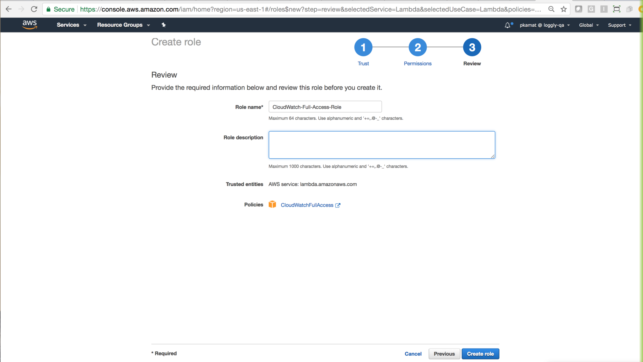

  4. Review settings, make adjustments as needed, and then click Create role.
