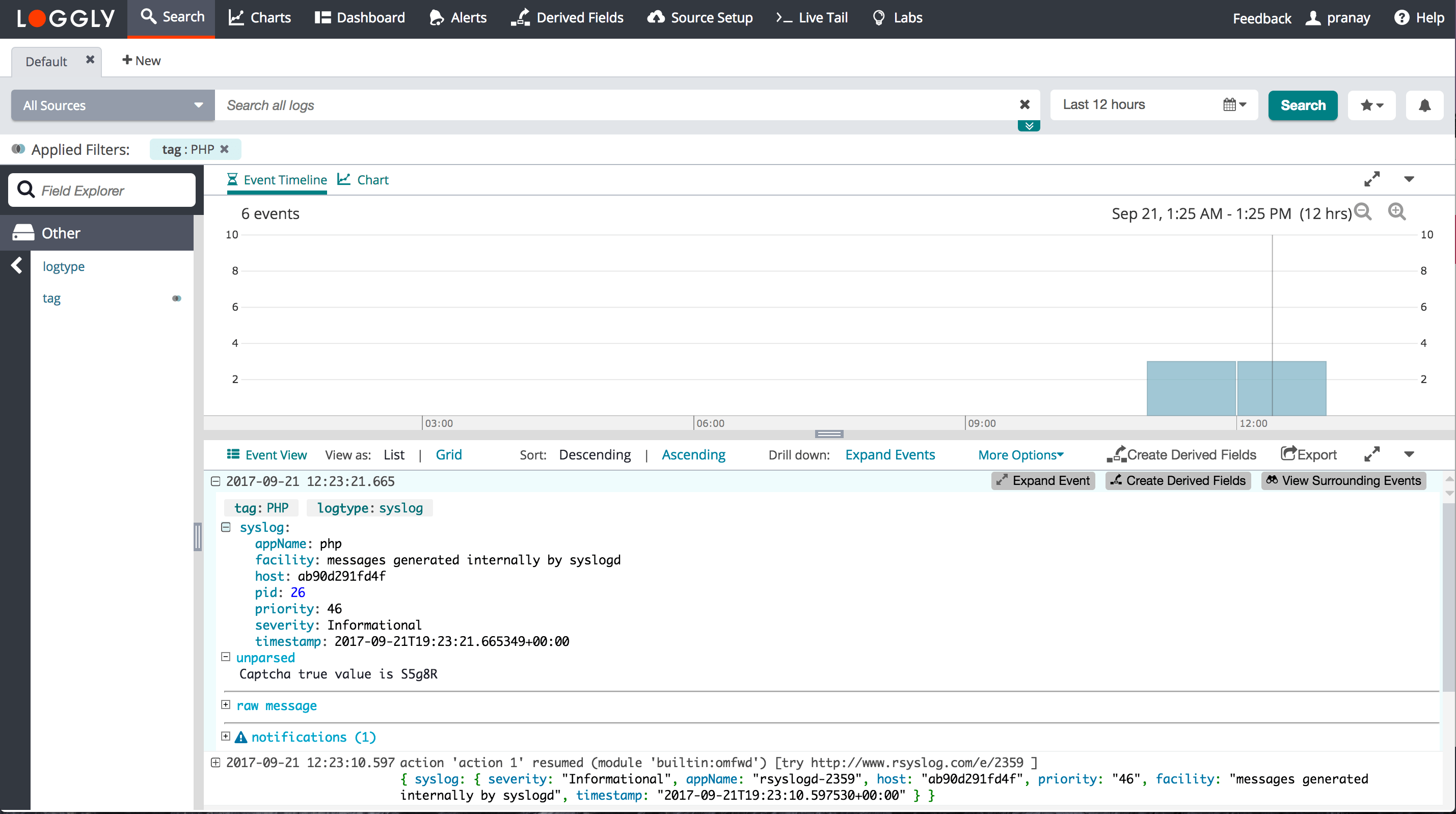

Search Loggly for this event. If it doesn’t work, see the troubleshooting section below.
syslog.appName:"php"
or using the tags you have used.
Click on one of the logs to show a list of php log fields (see screenshot below). If you don’t see them, please check that you are using one of our automatically parsed formats.
