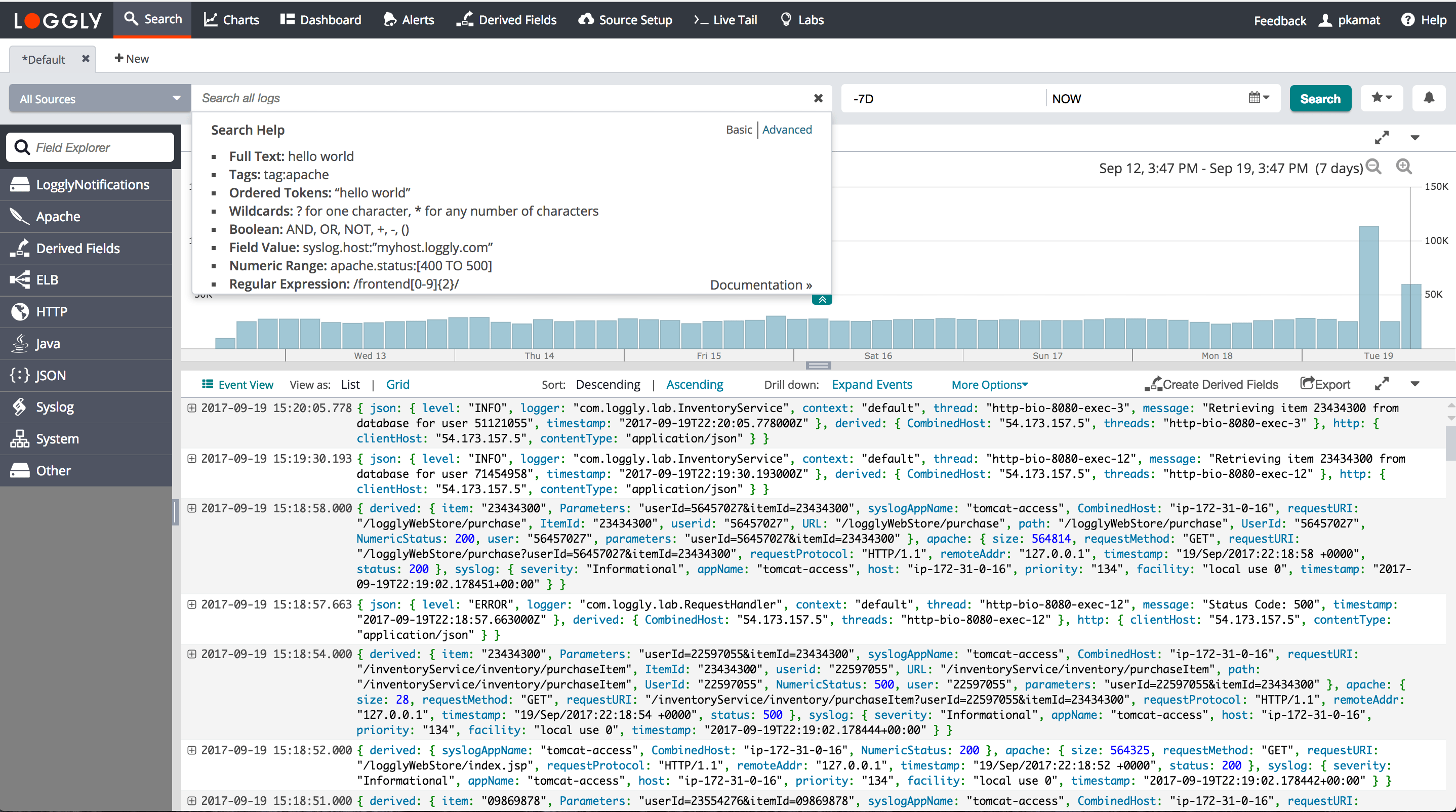

Loggly’s search query language is based on Apache Lucene. Review the following sections below to start putting your data to work:

Leave the search box blank and click Search. This way, you’ll see a full picture of what log data exists within Loggly.

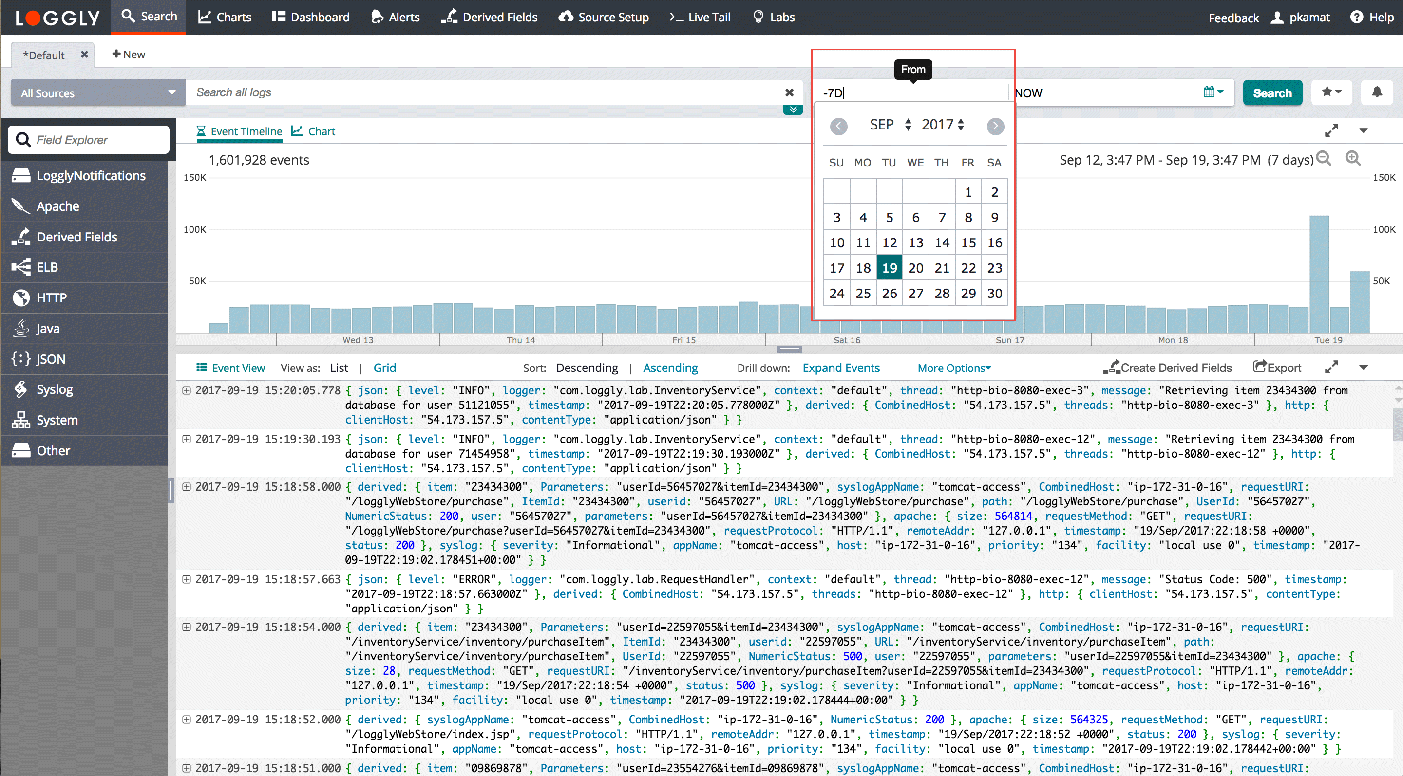

Time ranges can be relative or absolute. Relative time ranges are pegged to the current time. Quick picks for some relative ranges are available. To supply an absolute time range or a custom relative range, choose Custom time range from the date selector to see the option:
Custom Time Range Syntax
| Type | Description | Example |
| Absolute Dates | yyyy-MM-dd HH:mm:ss.SSS | 2013-08-11 00:00:00.000 |
| yyyy-MM-ddTHH:mm:ss.SSSZ | 2013-08-13T18:45:00.000Z | |
| Relative Dates | now | now |
| Last 5 weeks | -5w | |
| Last 12 hours | -12h | |
| Last 5 minutes | -5m | |
| Last 30 seconds | -30s |
