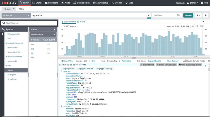

Click one of the logs to show a list of Apache fields (see screenshot below). If you don’t see them, check that you are using one of the automatically parsed formats.

Search Loggly for events with the Apache tag over the past hour. It may take a few minutes to index the event. If it doesn’t work, see Troubleshooting.
tag:apacheClick on one of the logs to show a list of Apache fields (see screenshot below). If you don’t see them, check that you are using one of the automatically parsed formats.
