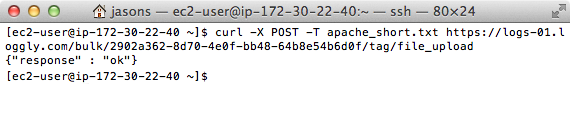

1. Send Data
Paste the following command into the terminal window, then run it to upload the sample data to your account.
curl -X POST -T FILE.TXT https://logs-01.loggly.com/bulk/TOKEN/tag/file_upload
Replace:
- FILE.TXT: enter the location of the log file you wish to read to the server
- TOKEN: enter your customer token from the source setup page
You should get the response ok code.

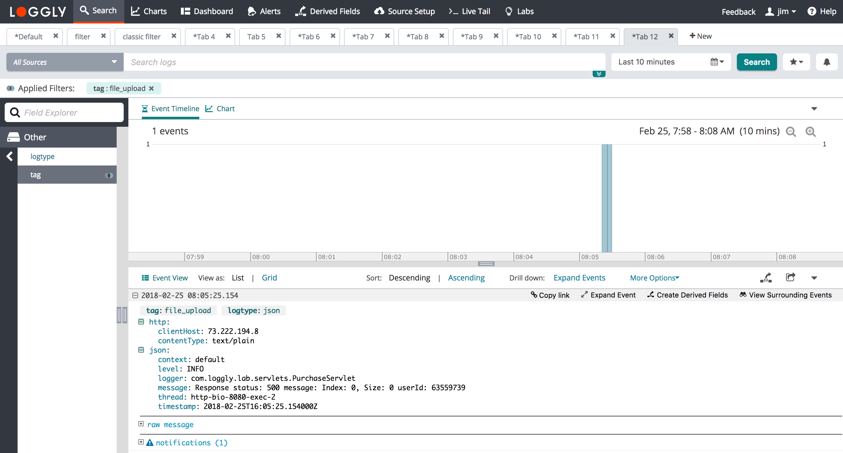

2. Verify
Search Loggly over the past hour for the file_upload tag to see your log events:
tag:file_upload
