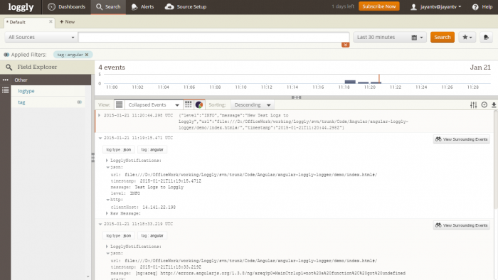

4. Verify Events
Search Loggly for events with the tag as angular over the past 30 minutes. It may take few minutes to index the event. If it doesn’t work, see Troubleshooting below.
            tag:angular
