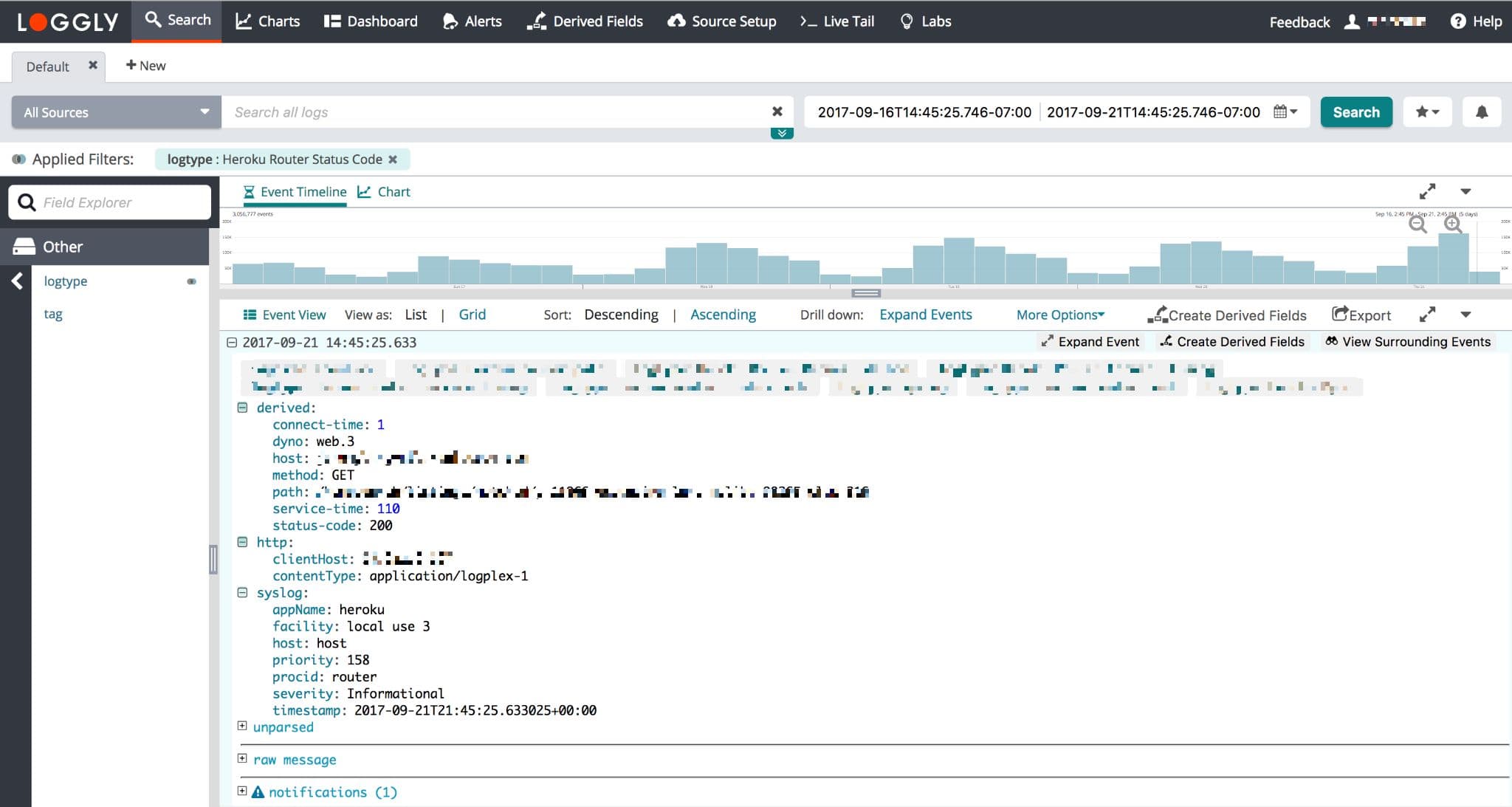

Heroku Log Example
Click on one of the logs to show a list of syslog fields. If you don’t see them, please check that you are using one of our automatically parsed formats.
