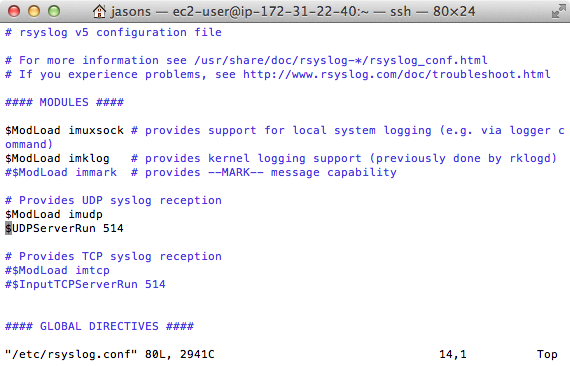

2. Configure Syslog Daemon for UDP Input
Open rsyslog’s configuration file
sudo vim /etc/rsyslog.conf
Uncomment these lines to accept UDP messages on the default port 514.
$ModLoad imudp $UDPServerRun 514
Restart the rsyslog service so the changes take effect
sudo service rsyslog restart

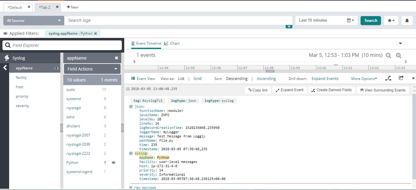

4. Verify Syslog Events
Search Loggly for events with the logtype as syslog over the past hour. It may take few minutes to index the event. If if doesn’t work, see the troubleshooting section below.
syslog.appName:Python
