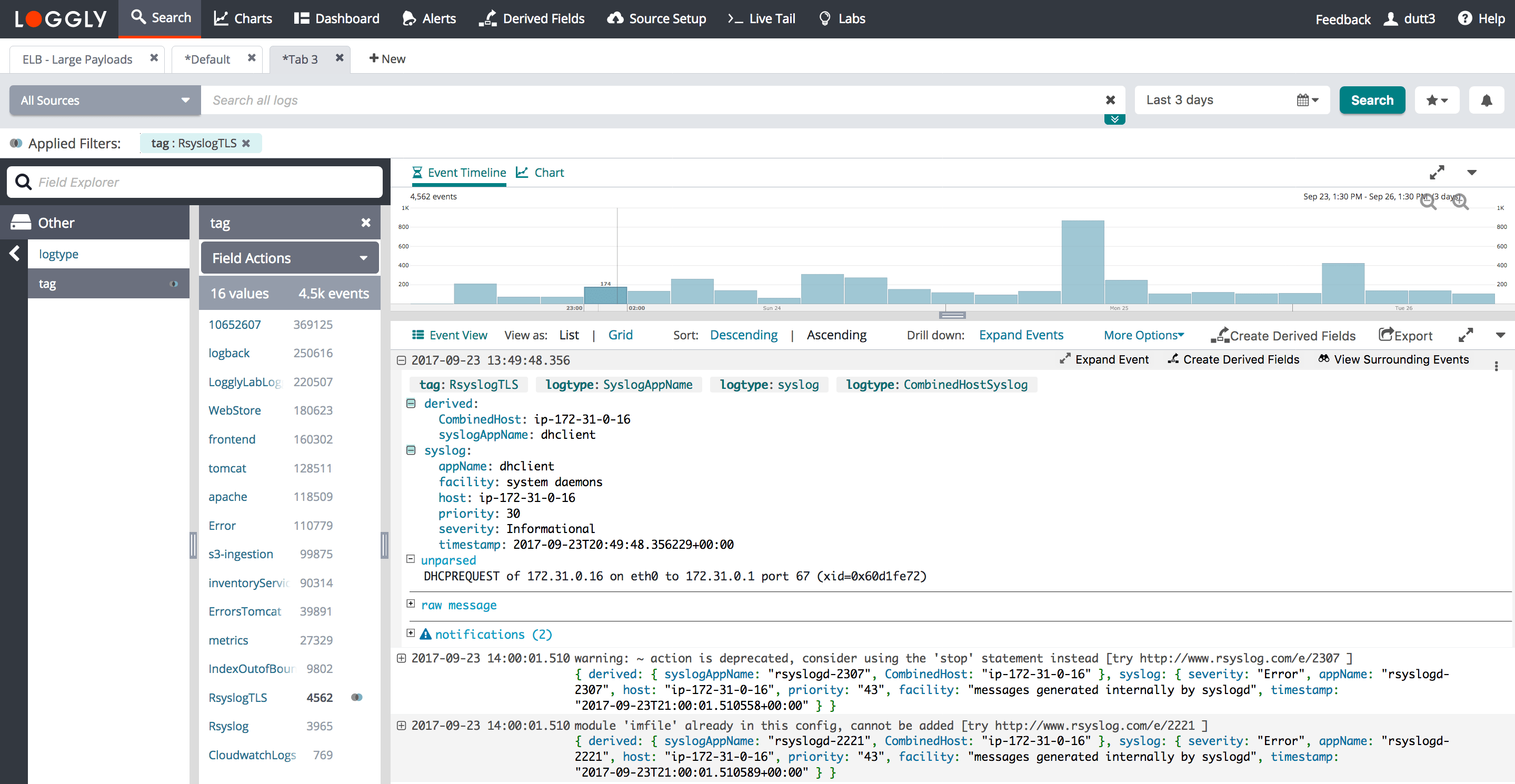

4. Verify Events
Search Loggly for events with the tag as RsyslogTLS over the past hour. It may take few minutes to index the event. If if doesn’t work, see the troubleshooting section below.
tag:RsyslogTLS
