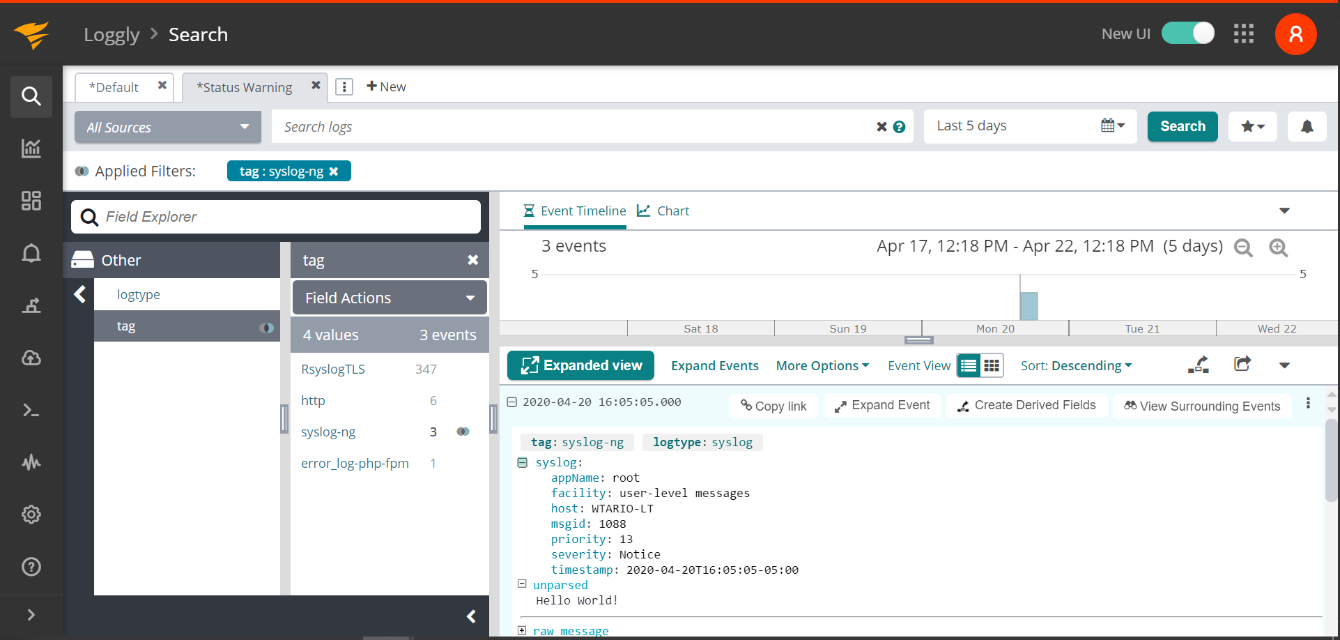

2. Verify Events
Search Loggly for events with the logtype as syslog over the past hour. It may take few minutes to index the event. If if doesn’t work, see the troubleshooting section below.
logtype:syslog
