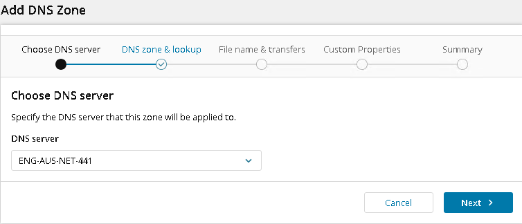

  1. From the DHCP & DNS Management screen, select DNS Zones and click Add.
    The Add DNS Zone window is displayed.
  2. Select the server that the secondary DNS Zone (see warning below) should be applied to, and click Next.
  3. The DNS Zone & Lookup tab is displayed.

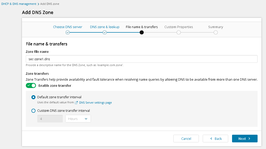

    The File Name & Transfer tab is displayed.
  6. Check the Enable Zone Transfer box, and either select to use the default zone transfer interval (inherited from the primary DNS Server settings) or enter a specific value here.
  7. Click Manage custom properties to add any custom properties. Click Next.

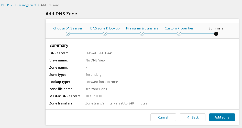

  8. Verify the details displayed, and then click Add zone.
    The secondary zone is created.
