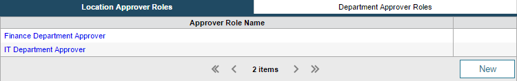

  1. Click Setup > Processes > Approver Roles.
  2. Click the Department Approver Roles tab.
  3. Click New.
  4. In the Approval Role Name field, enter a name that describes the role (for example: IT Department Approver).
  5. Click Save.
    The Department Approver Roles tab displays the new role.

  1. Click Setup and select Processes > Approver Roles.
  2. Click the Location Approver Roles tab.
  3. Click New.
  4. In the Approver Role Name field, enter a name that describes the role (for example, Austin Approver).
  5. Click Save.
    Your selected name is added as an approver role name.
