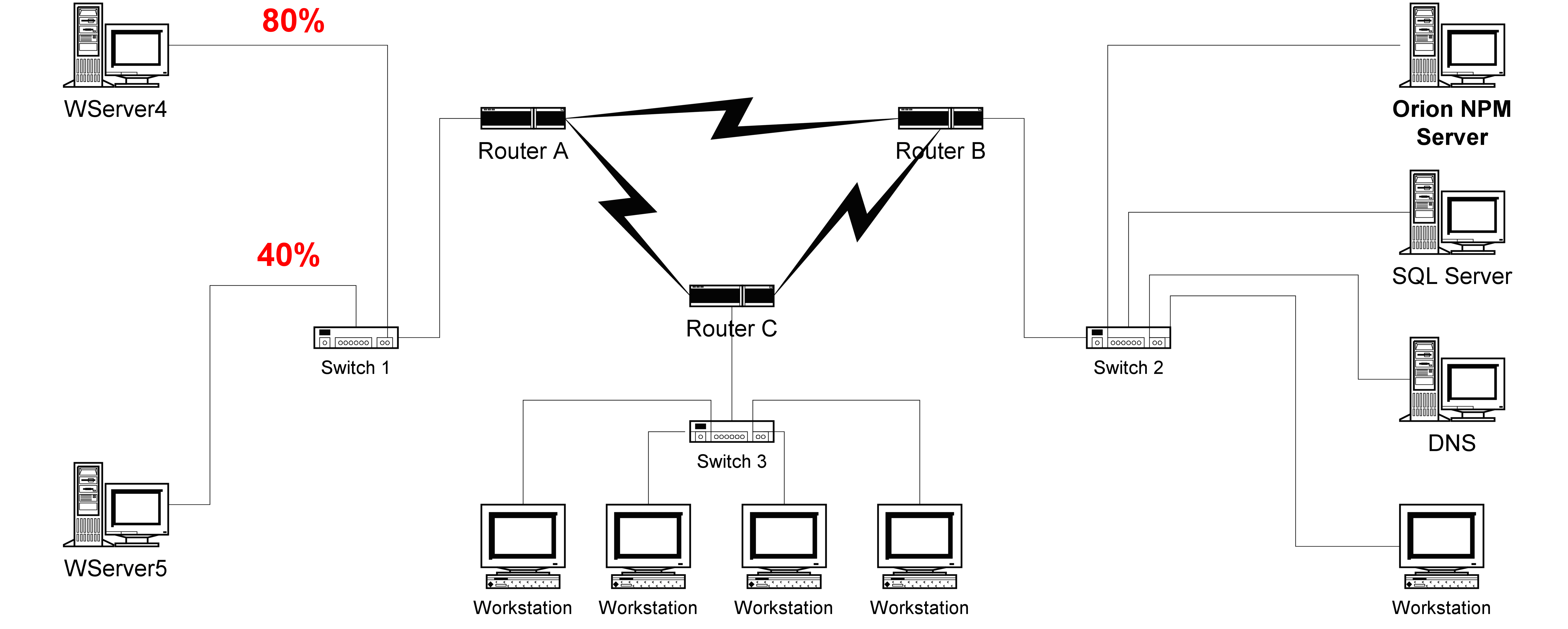

Failure of redundant servers
Review the following diagram. Both WServers are identical in order to provide fail over, redundancy, and load balancing. If WServer4 fails and the other server is still functioning, you may want to be alerted immediately during business hours, but not paged in the middle of the night. In this case, configure the alert for the failure of one WServer to be suppressed unless the other also fails.

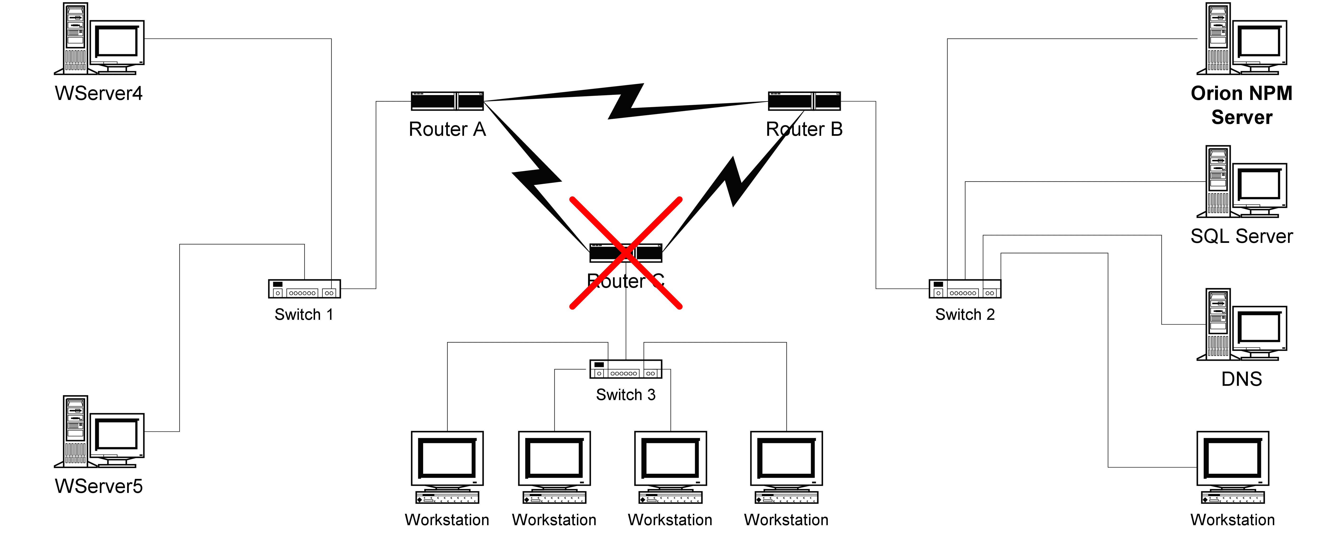

Apparent failure of dependent nodes downstream of a failed device
In the following diagram, dependencies exist among devices. If Router C fails, Switch 3 and all four Workstations become unreachable by NPM. You want to know that the Workstations have failed, but only if Router C and Switch 3 have not failed. Configure the alerts for failure of the Workstations to depend on Router C and Switch 3 being operational.

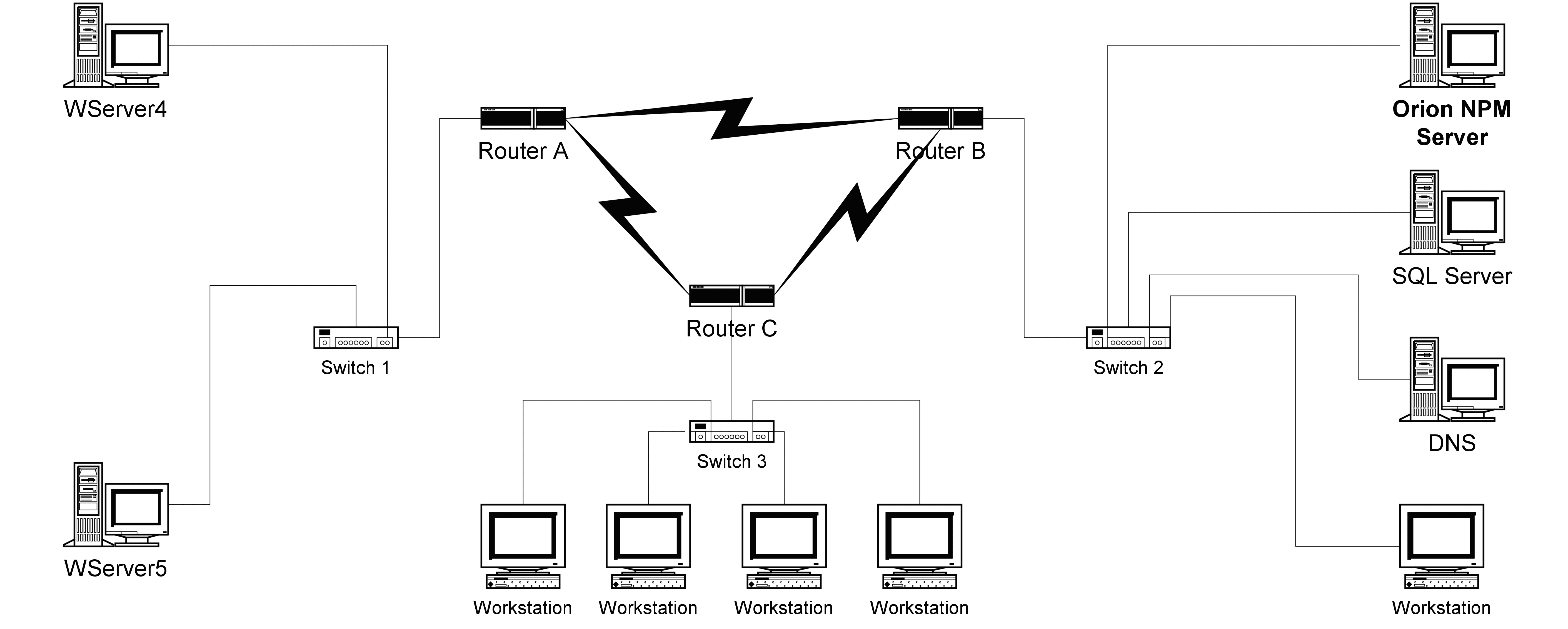

Failure of a network link when a redundant link remains functional
In reference to the previous diagram, during some hours, you may want to be notified of the failure of the link between Router B and Router C only if the alternative link through Router A is also down.
Failure of load balancing between devices
If you configured your network to balance traffic across your web servers, consider configuring an alert that notifies you of very high CPU utilization only if one or more is experiencing much lower usage.
