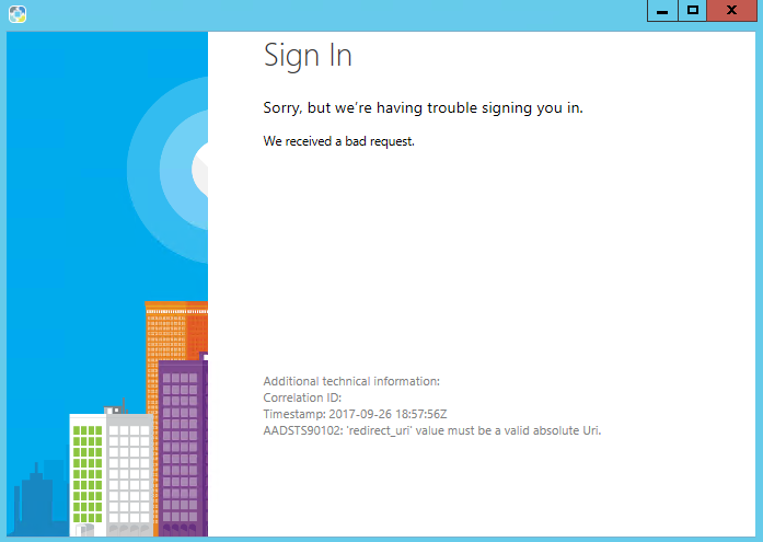

Troubleshooting Tips
Users who are not authorized encounter the following:
Note: Currently, the ODATA is missing the following functions and actions for some organization service messages:
