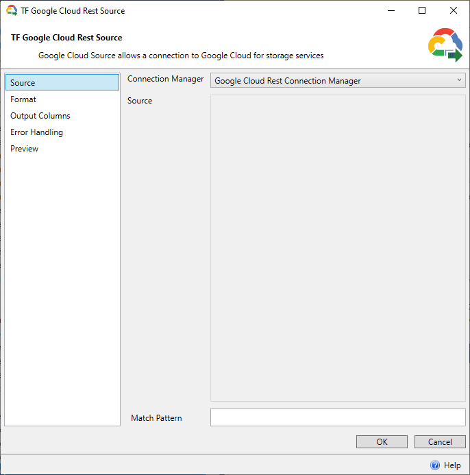

Google Cloud Rest Source and Google Drive Rest Source
Source
Begin by creating a connection manager that connects to the service's storage container.
Task Factory Google Cloud Rest Source

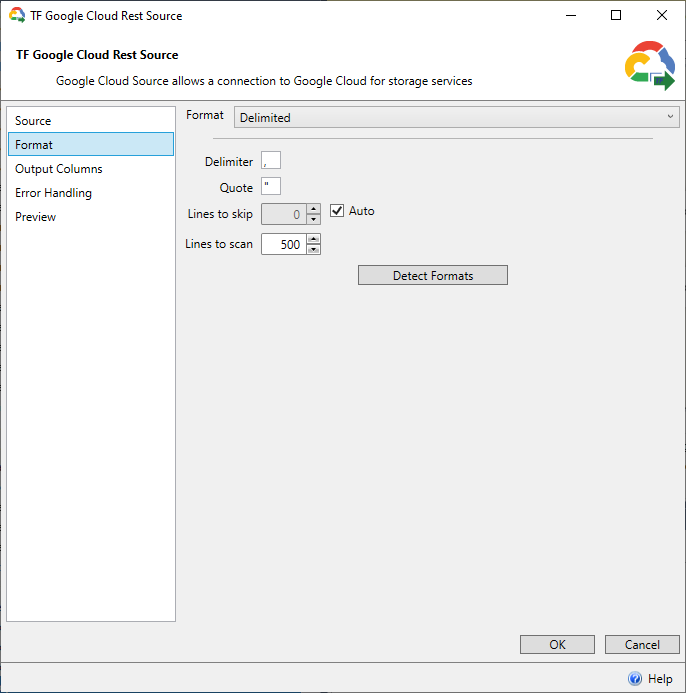

Format
The following formats are available:
Delimited Format
Users can manually configure the delimiter , quote identifiers, the lines to skip, and lines to scan. Select Detect Formats to configure these fields automatically.
Task Factory Google Cloud Rest Source Format Delimited
Option Description
Delimiter Identifies the character that separates columns. The default value is the comma (,).
Quote Identifies the character used to indicate a value (if present).
Lines To Skip Users can designate the number of lines to skip at the beginning of the delimited file.
Auto Automatically detects which lines to skip.
Lines To Scan  Determines the number of lines to scan when detecting the file.
 Detect Formats Select this button to begin scanning the chosen file.
Detected Delimited View - After the format is detected, a new view appears that allows users to configure or change different properties of the file.
Json Format
Task Factory Google Cloud Rest Source Format Json
Option Description
 Root Json Path JSON queries can return multiple levels, therefore, this field Identifies the root to be used.
