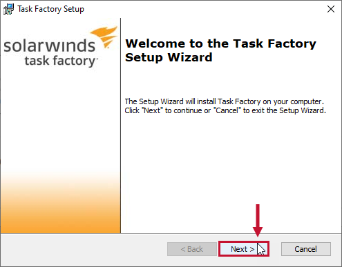

1. Start the Task Factory installer by running the TaskFactory.msi file.
2. Select Next to continue with the Task Factory Setup installer.
Task Factory Setup Wizard select Next

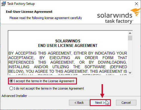

3. Select I accept the terms in the License Agreement and then select Next to continue.
 Task Factory Installer I accept the terms in the License Agreement

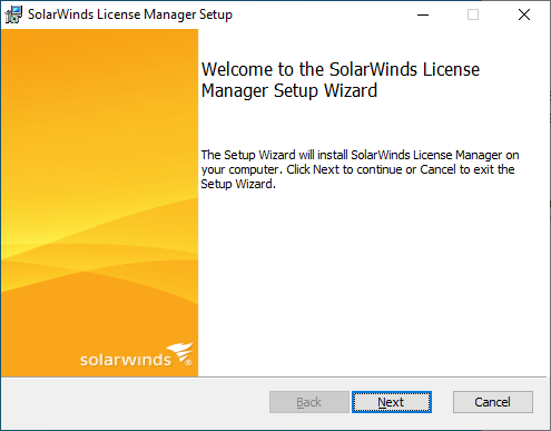

5.  The Task Factory installation includes the SolarWinds License Manager. If the Setup Wizard seems stuck on the Installing SolarWinds License Manager step, check to see if there is a UAC warning or other window that requires focus to continue. Once the SolarWinds License Manager Setup Wizard appears, select Next to continue.
Task Factory Installer SolarWinds License Manager Welcome Prompt

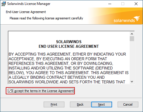

6.  Check the I accept the terms in the License Agreement box, then select Next to continue.
Task Factory Installer SolarWinds License Manager End User License Agreement

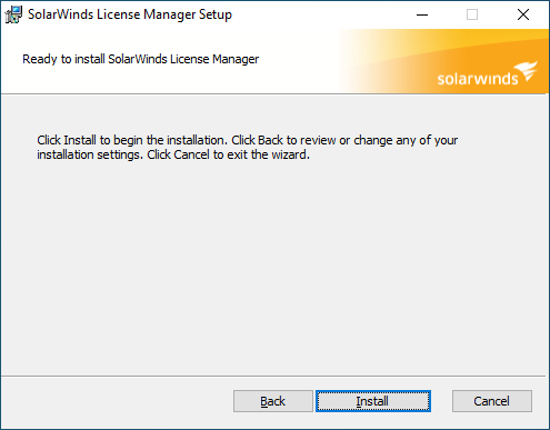

7. Select Install to start the installation process for the SolarWinds License Manager.
Task Factory Installer Install SolarWinds License Manager

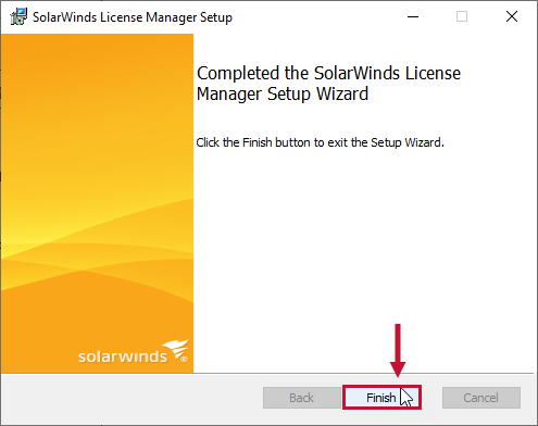

8. Select Finish to close the SolarWinds License Manager Setup screen and complete the Task Factory installation.Task Factory Installer Finish SolarWinds License Manager

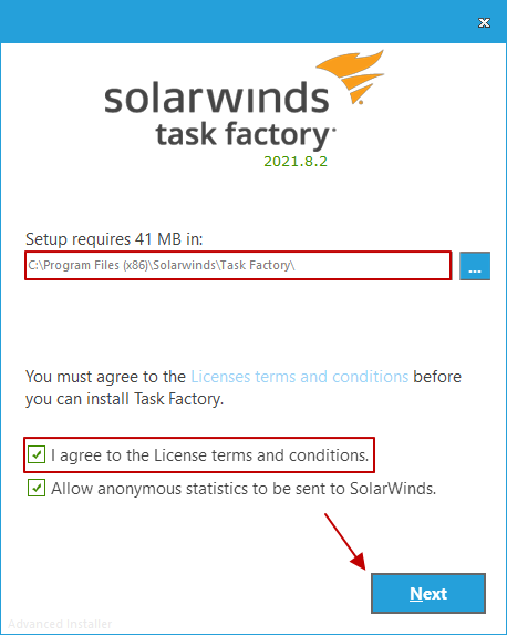

2. Select your install destination from the drop-box, then select the checkbox to agree to the license terms and conditions. Select Next to continue.

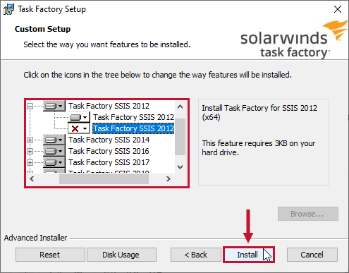

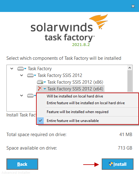

4. Select the Typical or Custom setup type, then select install.
Task Factory Custom Setup Components
Note:  The Typical setup is recommended for most customers.
Important:  If you choose the Custom installation for the 2016 version, you must include the 2012 and 2014 installations (which are selected by default).

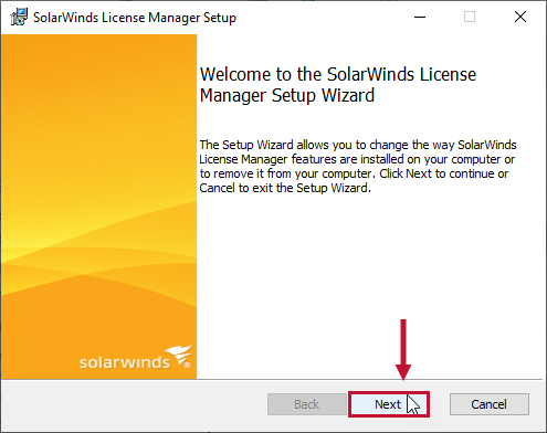

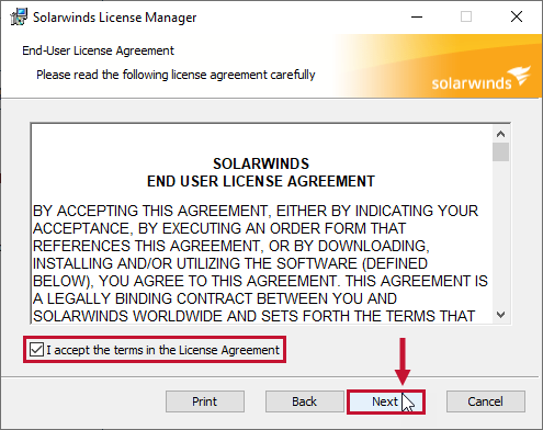

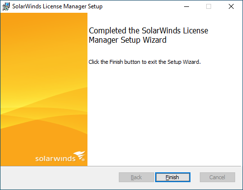

8. Select Finish to close the SolarWinds License Manager Setup screen and return to the Task Factory Setup Wizard.Task Factory Installer Finish SolarWinds License Manager

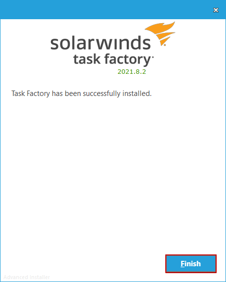

9.  After the installation is complete, the confirmation window displays. Select Finish to complete the installation.
Task Factory Installation select Finish
Success: The SolarWinds Task Factory installation is complete.

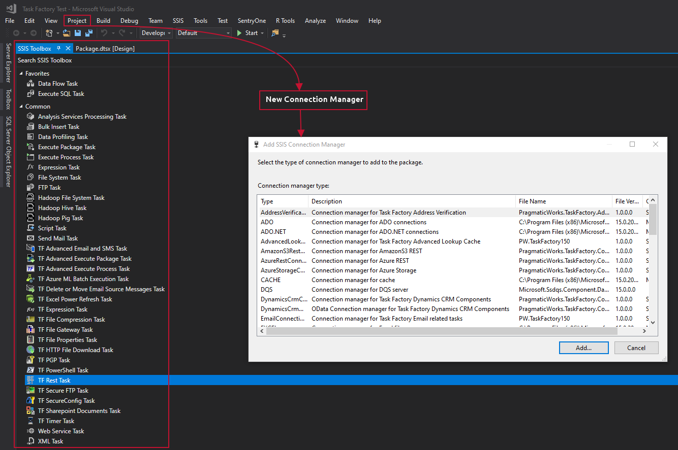

Task Factory in SSIS Toolbox
See the Task Factory Connection Managers article for instructions on adding new connection managers in Visual Studio.
Task Factory in the Visual Studio SSIS Toolbox and SSIS Connection Manager
Note:  If you do not see these options in Visual Studio, ensure you have installed Task Factory to an environment that meets the system requirements.
If your Task Factory components aren't displaying in the SSIS toolbox after installation, you may not be targeting a supported version of SSIS. See the Task Factory Items not showing up tab in the Common Errors article for more information.

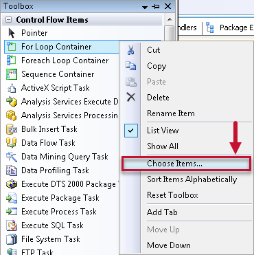

Adding Task Factory components in BIDS/Visual Studio 2010 or lower
Before you can use the Task Factory components in BIDS, you must add them to your toolbox.
Note:  Adding Task Factory components in BIDS is not necessary with SQL Server Data Tools (2012 or higher).

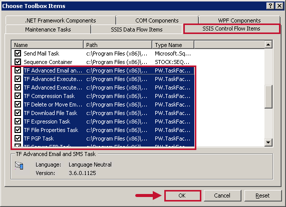

Complete the following steps to add the Task Factory components to your toolbox:
  1. Open an SSIS package, then open your toolbox (View > Toolbox).
  2. Right click the toolbox window and select Choose Items...
    Add Task Factory components to your toolbox
  3. Select the SSIS Control Flow Items tab and select all deselected tasks that begin with TF. Next, follow the same step with the SSIS Data Flow Items tab.
  4. After you have selected all Task Factory Control Flow and Data Flow items, select OK to save and confirm your selections. Add Task Factory Components to your toobox

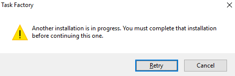

Another installation is in progress
If you receive this popup while installing Task Factory:
  1. Check Task Manager to see if another installation of Task Factory is running. If so, choose End Task.
  2. Restart the machine.
Task Factory Another Installation is in progress Error Message

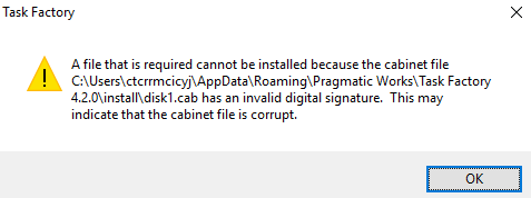

Task Factory Installer Fails To Complete Due To Invalid Digital Signature
See the article above for information about resolving issues related this error message:
A file that is required cannot be installed because the cabinet file C:\Users\...file.cab has an invalid digital signature. This may indicate that the cabinet file is corrupt.
Task Factory Invalid Digital Signature Error Message
