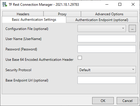

Basic Authentication Settings
Task Factory Rest Connection Manager Basic Authentication Settings tab
Option Description
Configuration File The file path to the configuration file. The configuration file can be used to auto-populate the Rest Source and Destination's endpoint URLs. Select the drop-down to view all config files currently in the repository.
The repository's location is C:\Program Files (x86)\Pragmatic Works\Task Factory\OAuth2ConfigFiles. You can add new config files to this location which appear in the dropdown.
Note:  For config files that exist in a different location, select the ellipsis to launch a file explorer window to navigate to the file.
Skip Authentication Option for endpoints that do not require authentication.
Note:  Open the component properties to configure this option.
User Name The username needed to authenticate to the endpoint URL.
Password The password that allows you to authenticate to the endpoint URL.
Use Base 64 Encoded Authentication Header Select when Base 64 Encoded Authentication is used by an endpoint. This option takes your username and password delimited with a colon ( : ), and Base 64 encodes them. This encoded value is then sent as a header.
Note:  If you've configured your API with Postman, this option is configured automatically.
Security Protocol The Security Protocol used by the API.  The Default option uses the TLS version used by your .NET version by default. See the following chart for more information:
.NET VersionTLS Support Information
.NET 4.6 and aboveSupports TLS 1.2 by default.
 .NET 4.5
TLS 1.2 is supported, but you need to opt-in to use it. Execute the following code before making a connection to a secured resource to make TLS 1.2 the default :
  • ServicePointManager.SecurityProtocol = SecurityProtocolType.Tls12
.NET 4.0TLS 1.2 is not supported. If you have .NET 4.5 (or above) installed on the system, you can opt in for TLS 1.2 even if your application framework doesn’t support it. SecurityProtocolType in .NET 4.0 doesn’t have an entry for TLS1.2, so you need to use a numerical representation of this enum value:
  • ServicePointManager.SecurityProtocol = (SecurityProtocolType)3072;
.NET 3.5 or belowTLS 1.2 is not supported, and there is no workaround. Upgrade your application to a more recent version of the framework.
Base Endpoint URL The endpoint url for your REST connection.
Note:  This setting is optional.

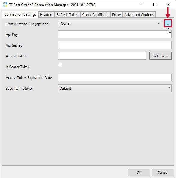

Connection Settings
Task Factory Rest OAuth2 Connection Manager Connection Settings tab
Option Description
Configuration File You can create and use configuration files to setup the OAuth2 connections. Select the down arrow to view all config files currently in the repository.
The repository's location is C:\%PROGRAMFILES(X86)%\SentryOne\Task Factory\OAuth2ConfigFiles. You can add new config files to this location which appear in the drop-down.
Additional Information: For a tutorial explaining configuration files for the Rest OAuth2 connection manager, see the following video.
Api Key and Api Secret Authentication information provided to users at the application's developer site.
Access Token To obtain this information if you do not already have it, select the Get Token button and complete the information requested in the Token Getter user interface.
Is Bearer Token Select this option if the Access Token is a bearer token.
Access Token Expiration Date The expiration date of the access token.
Note:  This settings is optional.
Security Protocol The Security Protocol used by the API.  The Default option uses the TLS version used by your .NET version by default. See the following chart for more information :
 .NET 4.5

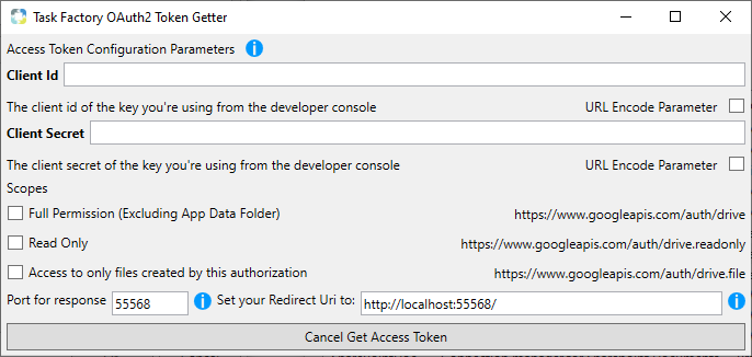

Token Getter (opened when Get Token button is used.)
Task Factory OAuth2 Token Getter
Note:  Please see your service's online documentation to assist in retrieving the information below.
Option Description
Choose Settings File You can select pre-configured settings for several popular services including, but not limited to: Google, GoToMeeting, and PayPal Sandbox.
Note:  You will use .oauth files for this option, which can be found in the following directory C:\%PROGRAMFILES(X86)%\SentryOne\Task Factory\OAuth2ConfigFiles
Client / Api Key Authentication information provided to you at the application's developer site.
Note:  This should match the API Key from the Connection Settings window.
Client / Api Secret Authentication information provided to you at the application's developer site.
Note:  This should match the API Secret from the Connection Settings window.
Authorization Request Url The URL used to request authorization from the service.
Example: https://api.citrixonline.com/oauth/authorize?client_id={ApiKey})
 Access Token Request Url The Url used to request an access token from the service.
Example: https://api.citrixonline.com/oauth/access_token
Use Code Challenge Select to use a challenge code.
Code Challenge Method Select the available challenge code method: Plain or S256.
Resource The server that will handle the authenticated request.
Include Nonce Select to include nonce.
Nonce Length Enter the desired nonce length.
Response Mode The format of the request that's required for the call.
Response Type The type of the request that's required for the call.
Scopes The list of permissions that you want to use in the call.
Listen Port The port on your local machine where you want to send the token request response.
Your Redirect Uri Use this as your Redirect Uri in your OAuth2 App settings.
Use Basic Authentication Select to use Basic Authentication.
Get Access Token Selecting this button opens the (configured) service's online authentication screen in the window below. To complete the process, enter the credentials of the account used to access the service. If successful, the Token Getter window closes and you return to the Connection Settings window.
Note:  Bad requests should redirect to a URL configured either in the application or the access token request URL. You can also copy the URL to help troubleshoot invalid requests.

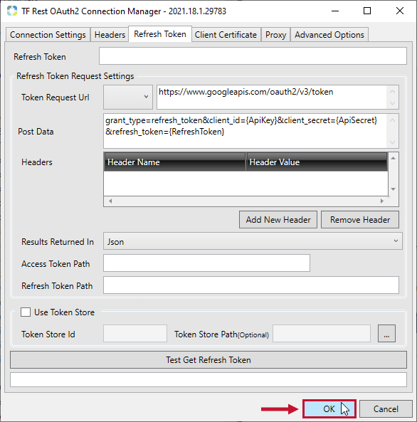

Refresh Token (Results Returned In JSON / XML)
Task Factory Rest OAuth2 Connection Manager Refresh Token Json
Note:  When you get an access token manually from the get token button or you've copied it from your service, it only does this once which could cause potential failures in your package. You need to have a refresh token setup to get subsequent tokens in your package.
Additional Information: For information about OAuth 2.0 grants, see the following guide.
Option Description
Refresh Token Authentication information provided to you at the application's developer site.
Token Request Url The URL that returns a refresh token. Example: https://api.citrixonline.com/oauth/access_token
Headers Allows you to add headers within the refresh token. Select Add New Header to add a header. Select Remove header to remove a header.
Results Returned In Specifies how results are returned from the application (JSON, XML, or String.)
Results Returned In Specifies how results are returned from the application (JSON or XML.)
Access Token Path The token path for the access token. Example: access_token
Refresh Token Path The token path for the refresh token. Example: refresh_token
Group Index Identifies the index position to return (0 based).
Use Token Store This option creates a file on your machine that saves the access token, and refresh token in an encrypted format.
Token Store Id Identifies the Token Store Id.
Token Store Path (Optional) Identifies the Token Store path.
Test Get Refresh Token Select this option to test the retrieval of the Refresh Token.

Configuration Files
Additional Information: Customize the configuration files to fit your needs. For a full list of the configuration files for Task Factory Rest connection managers, see the Task Factory GitHub.
You can choose to create or select a configuration file to help you configure your OAuth2 connection manager. Select a link to download the corresponding config file.
Select a configuration file to configure your OAuth2 Connection Manager by completing the following steps:
  1. Select the ellipsis  to open the file explorer. Navigate to the .config file and select OK to open the OAuth2 Token Getter. Note:  You can also select an applicable Configuration File from the drop-down menu.
    Task Factory Rest OAuth2 Connection Manager select ellipsis
  2. Enter your access token configuration parameters in the OAuth2 Token Getter.  Select Get Access Token, to open a sign-in window, and enter the application's credentials. Note:  The Task Factory OAuth2 Token Getter will require different Access Token Configuration Parameters based on your configuration file selection. This example displays the Google Drive OAuth2 Token Getter requirements.
    Task Factory OAuth2 Token Getter Get Access Token
  3. After permission is granted, the OAuth2 Token Getter window closes and the Refresh Token tab populates with the required information. Below is an example of Google Analytics. (The actual Refresh Token has been deleted for security.) Select OK to close the Connection Manager. Task Factory Rest OAuth2 Connection Manager populated

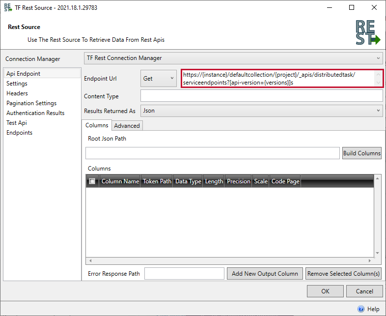

Task Factory Rest Source Icon The REST Source allows you to connect to a web service that utilizes a REST API and extracts data in XML or JSON format. See the Rest Source Connection Manager, Rest Source OAuth Connection Manager, and the Rest Source OAuth2 Connection Manager to learn more about configuring the component's connection manager.
API Endpoint / Output Columns
Task Factory Rest Source Api Endpoint
Option Description
Endpoint URL In this field, you set the URL of the web service. You should also choose whether you're making a call to receive information (Get), or making a request to the service (Post).
To add a user variable as a parameter to the API Endpoint URL, use the following syntax: <@Namespace::VariableName> or <@Namespace::ParameterName>
Note:  The angle brackets (<>) and the commercial at (@) are required in the syntax.

Post/Put/Delete/Patch  Data You set the URL of the web service and choose the method making the call:
  • Post - (Default) Request that the destination URI perform an action with the provided data.
  • Get - Retrieves data from the destination
  • Put - Stores data at a URI and can be used to create a new entity or update an existing one.
  • Delete - Requests that data be removed
  • Patch - Requests an update to the specified fields of an entity at a URI.
Note:  See your application's API page to determine the appropriate action
Additional Information: For more information about these Rest options, see the following guide.
Content Type Identifies the type of content that is requested from the API.
Results Returned As Selects the format for the results:  XML, String, or JSON.

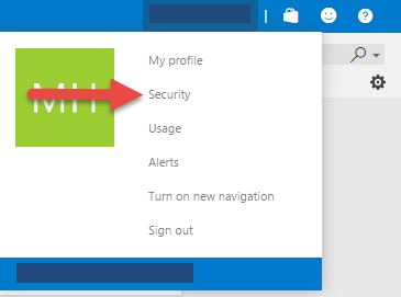

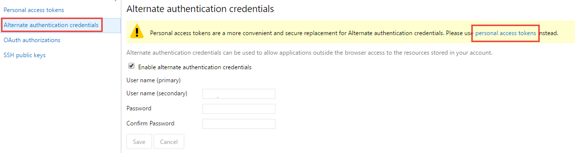

  1. Before configuring the Rest Source, you need to set up alternative credentials in VSTS. This can be done by accessing the Security Settings for the account. Set up alternative credential in Visual Studio Team System
  2. Select Alternate authentication credentials, and then set up the username and password: Alternate authentication credentials
    Alternatively, the personal access tokens (highlighted above) can be used as the password in the REST Source.

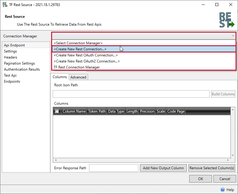

  4. Create a new Basic Authentication connection manager:
    Task Factory Rest Source Create New Rest Connection
  5. Enter the username and password in the connection manager.

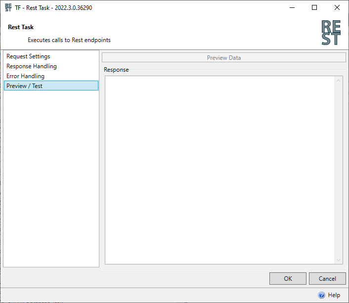

Preview / Test
 Task Factory Rest Task Preview / Test
Once properly configured, select the Preview Data to view an output sample. The preview also returns raw XML/JSON/string data that can assist in configuring the component further.

Connection Manager
  1. Create a new, or open an existing Visual Studio SSIS project and then create a new Rest OAuth2 Connection Manager. Google Analytics uses a Rest OAuth2 Connection Manager.
  2. In the Rest OAuth2 Connection Manager window, select the Google Analytics Configuration file to open the Token Getter Window.
  3. Enter the Redirect URI, the Client ID, and the Client Secret into the appropriate fields in the Token Getter. Select Get Access to establish access. Select Allow Access to the API to continue. If you are connecting to the API for the first time, you may need to log into the API to proceed.
Note:  Providing the above information into the Token Getter auto-populates many fields within the Connection Manager, including the Refresh Token tab.
Rest Source
  1. Consult the applicable API reference guide for information about Endpoints.
  2. Create a new Rest Source. Right click the Rest Source and select edit to configure the Rest Source.
  3. Connect to the OAuth2 Connection Manager by selecting the Connection Manager from the Connection Manager drop-down list. Some fields within the Rest Source auto-populate based on the information provided to the connection manger in the configuration file.
  4. In the Api Endpoint tab, enter the applicable Endpoint URL into the appropriate field, and then select the action you want the rest source to take.
  5. Select the Test API tab to test the data that the API returns. Select Preview Data to display a Raw Response from the API.
  6. Select the JSON Properties tab to configure the Root JSON path. Enter the applicable Root JSON Path, and then select OK to complete the Rest Source.
Note:  For more information about the processes involved with this example, see the video tutorials below.
