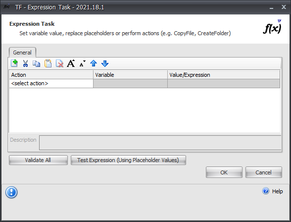

Task Factory Expression
Expression Task
| Task Icon | Task Description |
The Expression Task is used to set variables and call functions using our extensive expression engine. Each action is evaluated in the order they appear in the grid. |
| Option | Description |
| Action | The action this step in the expression task performs. There are five actions that can be performed:
| Variable | If the action requires you to select a variable, a drop down with all user defined variables displays. |
| Value/Expression | Depending on the action, this contains either a static value or an expression that executes at runtime. |
| Validate All | Selecting this button validates all the expression set in the Value/Expression column. |
| Test Expression | Selecting this button executes the selected expression using temporary values. |

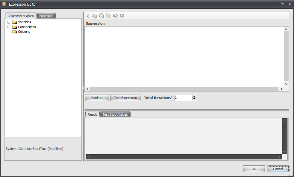

Expression Editor
The Expression Editor is used to create and edit expressions that are used in any expression engine in a Task Factory task.
UI Overview
| Columns / Variables Tab |
The Columns/Variables tab list all of the columns available for the current component being edited, the variables and parameters and the connection managers available for the package. The columns node also lists any variable expressions defined for the current component. Any icon in the tree view that has a green icon next to it means it is being used by an expression. |
| Functions Tab |
The Functions tab lists all of the available functions that can be used in the advanced derived column. All functions are grouped into an appropriate group based on what the function either does or returns. |
| Expression Editor |
The Expression Editor is used to define the expression for the column or variable expression. The syntax highlighting makes it easy to recognize the functions you are using in the expression. You can use multi-line expressions and add comments to your expressions by using the /* */ syntax. Any column, connect, or function can be dragged and dropped from the tree view to the Expression window. |
| Validate / Test Expression Buttons |
The expression editor allows you to validate and test your expressions during design time. The results appear in the Result tab. |
| Total Iterations? | The number of times the expression will execute when you select Test Expression. |
| Test Input Values Tab | Column/Variable, Data Type, Length, and Input Value information for the tested expression. |
