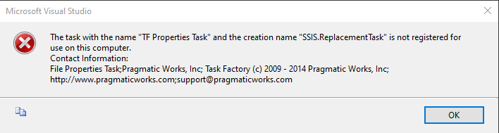

SSIS.ReplacementTask Error
You may run into the SSIS.ReplacementTask error when you try to run a package after installing a new version of Task Factory.
TITLE: Microsoft Visual Studio ------------------------------ The task with the name "TF Properties Task" and the creation name "SSIS.ReplacementTask" is not registered for use on this computer. Contact Information: File Properties Task;Pragmatic Works, Inc; Task Factory (c) 2009 - 2014 Pragmatic Works, Inc; http://www.pragmaticworks.com;support@pragmaticworks.com

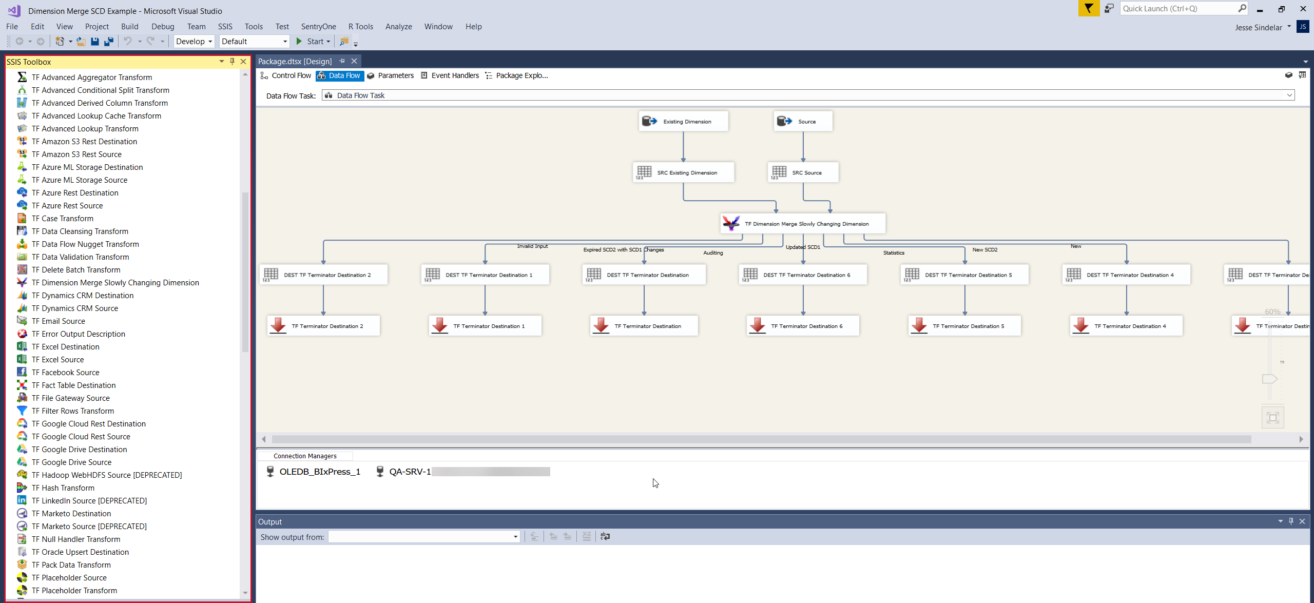

Task Factory Items are not showing up in the SSIS Toolbox
Symptoms
Recently downloaded Task Factory components are not displaying in the SSIS Toolbox.
Beginning with SQL Server Data Tools 2016, backwards compatibility was added for building and editing packages for previous versions of SQL Server Integration Services. Opening your package in a newer version of Visual Studio may cause the package to target a version of SSIS that does not have Task Factory support. For example, if you custom installed Task Factory to support only SSIS 2014, and then you tried to work on a project that is targeting SSIS 2012, the Task Factory items won't display in your SSIS toolbox.
Solution
To ensure that the Task Factory components display in the SSIS toolbox, you can uninstall your current version of Task Factory, then reinstall Task Factory (making sure to select the versions of SSIS that you plan to work with).

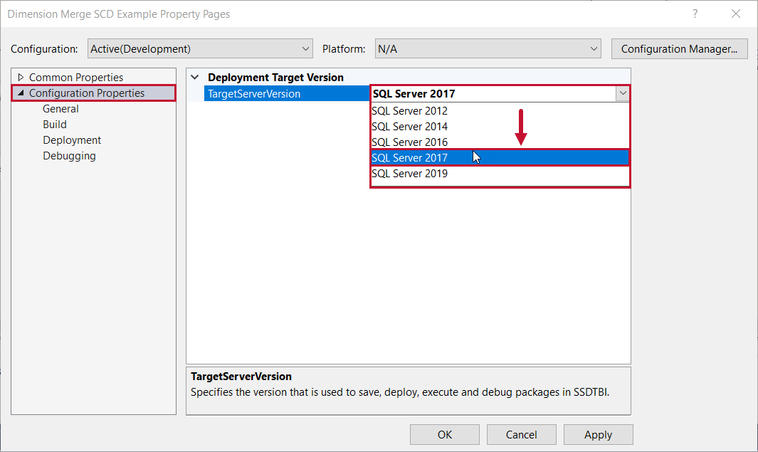

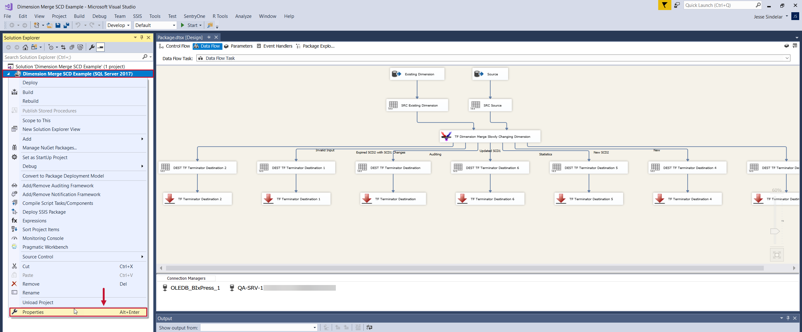

You can also change the TargetServerVersion of the SSIS project to match your installed version of Task Factory. To do this, complete the following steps:
1. Open your Visual Studio project. Right click your Project in the Solution Explorer window, then select Properties to open the Property Page window.
2. Select Configuration Properties, then select the desired TargetServerVersion from the drop-down list. Select OK to save your changes.
3. Save and close your package. Re-open the package to display the Task Factory components.

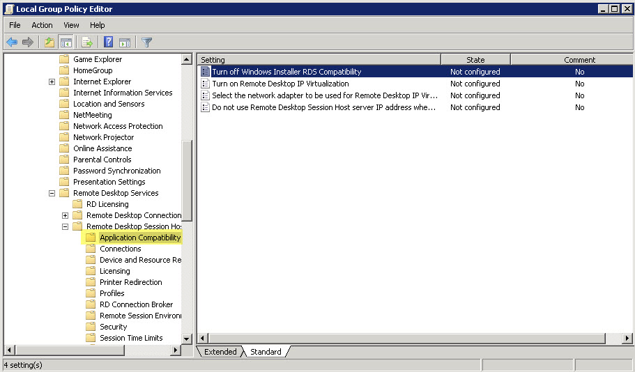

Resolution 1 RDS Compatibility
If you are using remote access to the machine where you are installing Task Factory, RDS compatibility may be the issue.
                                    Open the Local Group Policy Editor (gpedit.msc)
                                    In the left pane, go to Computer Configuration > Administrative Templates > Windows Components > Remote Desktop Services > Remote Desktop Session Host > Application Compatibility.
                                    In the right pane, double-click Turn off Windows RDS Compatibility.
                                    Select Enabled and then click OK.
                                    Run the Task Factory installer again.
                                    Optional: Repeat steps 1-4 and return the "RDS" option to its previous setting. (E.g., set the option back to Enabled).

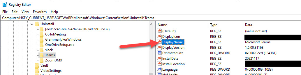

Resolution 2 Broken display names
If you are not remotely accessing the machine where you are attempting to install Task Factory, the issue will be that some other product on the machine has uninstalled information in the Registry. Look under HKEY_CURRENT_USER\SOFTWARE\Microsoft\Windows\CurrentVersion\Uninstall and you will find a Registry key that does not contain a DisplayName. Add an entry to the key called "DisplayName" with a blank value for the malformed Registry to address this issue.
