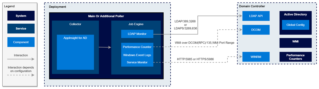

How AppInsight collects Active Directory data
In the AppInsight for Active Directory template, WinRM is the default transport method used to fetch data for WMI-based component monitors. If WinRM is disabled, WMI uses DCOM/RPC communication to allocate ports within the standard dynamic port range, 1025 — 65536. Enable the Inbound Rules in the WMI group and create firewall exceptions to allow TCP/UDP traffic on ports 1024 — 65535 so monitored objects that use WMI can be mapped.
  • WMI TCP ports 1025 — 5000
  • TCP ports 49152 — 65535
The following diagram shows how AppInsight uses various protocols to collect AD data:
