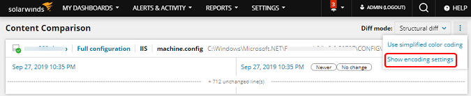

To select encoding settings from the SCM home screen, under Recent Configuration Changes, click on a node to view Node Details. Next, click Configuration Comparison, and then click the three dots at the upper right of the page. Select Show encoding settings.

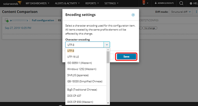

Next, select the appropriate character encoding type from the drop-down list and click Save.
Encoding settings - step 2
Changing the encoding for one item changes the encoding for all other configuration items created by the same profile element. For example, if you have a File element in a profile that uses a wildcard character to match all the files in a certain directory, changing the encoding for one of those files changes the encoding for all the files in the directory.

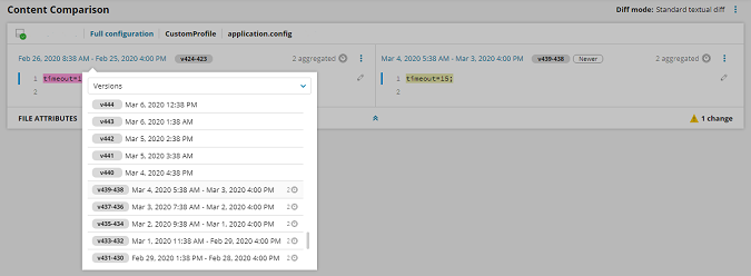

SCM displays a list of each unique copy of the content over time. It handles aggregation of versions, so the tracked changes roll up, and the most recent content is shown. SCM saves the number of changes that are made in that time period, and it allows you to drill down to previous versions.
To select a version from the version picker on the Content Comparison page, click the hyperlinked date above the comparison panels. You can select any of the versions listed to view it.
Version pickerdrop-down menu
If aggregation occurred, you can see it in this version picker drown-down menu. The number of aggregations are listed to the right of the version time information.
