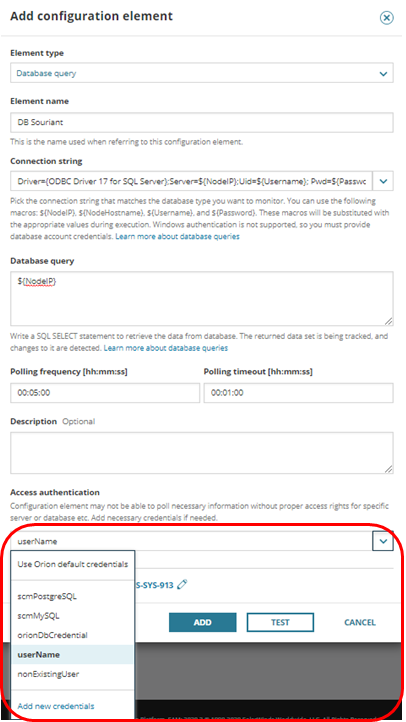

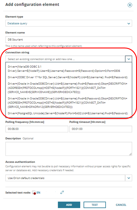

- Select, modify, or create a new connection string using the drop-down menu.
- Fill in or edit the element with the database query you want to test or that is collecting the desired configuration data.
- Specify SQL credentials and click TEST to test the connection.
 Note: Due to security concerns, SolarWinds recommends that you avoid using username and password values in the Connection String. Instead, use the ${username} and ${password} macros along with specified credentials to ensure that sensitive values are properly secured.

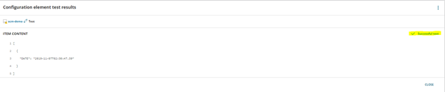

- After following these steps, the test should be successful. The success of the test is indicated on your test results page.

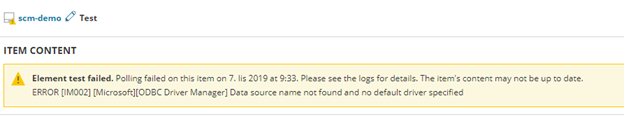

 However, if there is an issue, an error message is displayed to help you start troubleshooting.
