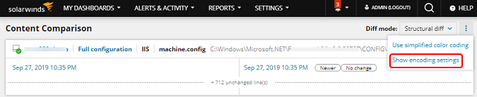

Set character encoding
By default, all items in the line-by-line comparison are displayed using UTF-8 encoding. Changing the encoding changes only the way the item is displayed and does not alter the underlying data. In environments that contain other character types, such as Japanese or Traditional Chinese, users can select the appropriate encoding settings so that characters are displayed correctly when viewing content comparisons.
To select encoding settings from the SCM home screen, under Recent Configuration Changes, click on a node to view Node Details. Next, click Configuration Comparison, and then click the three dots at the upper right of the page. Select Show encoding settings.

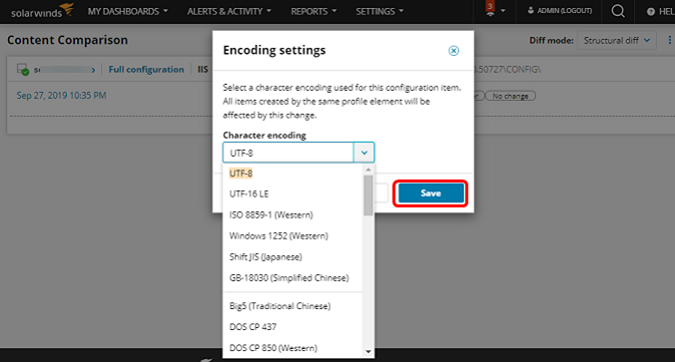

Next, select the appropriate character encoding type from the drop-down list and click Save.
Changing the encoding for one item changes the encoding for all other configuration items created by the same profile element. For example, if you have a File element in a profile that uses a wildcard character to match all the files in a certain directory, changing the encoding for one of those files changes the encoding for all the files in the directory.

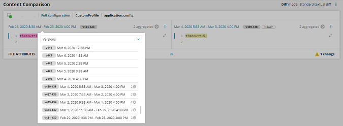

View multiple versions of comparison content
SCM displays a list of each unique copy of the content over time. It handles aggregation of versions, so the tracked changes roll up, and the most recent content is shown. SCM saves the number of changes that are made in that time period, and it allows you to drill down to previous versions.
To select a version from the version picker on the Content Comparison page, click the hyperlinked date above the comparison panels. You can select any of the versions listed to view it.
If aggregation occurred, you can see it in this version picker drown-down menu. The number of aggregations are listed to the right of the version time information.

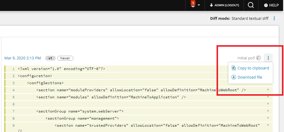

Download or copy comparison content
You can now download or copy comparison content to the clipboard. Click the three dots on the top right side of the Comparison page, and select Copy to clipboard or Download file from the drop-down menu.
The copy comparison content feature is available on Chromium-based browsers only.
