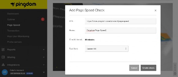

  1. Click on the Page Speed tab under Monitoring in the left-hand navigation on your My Pingdom account.
  2. Click on Add check in the top right-hand corner to bring a modal where we’ll enter the details for this check.
  3. Enter the URL of the page you wish to monitor. Note that Page Speed monitors the load speed of a particular page, not an entire website, so be specific! For example, if we want to monitor the product page for Page Speed on the Pingdom website, we need to enter https://pingdom.com/product/page-speed as the URL.
    Don’t forget to give it a name that will allow you identify which check is which in your dashboard. This is important if you plan to have multiple, similar Page Speed checks later.
  4. The check interval is automatically set to test the page every 30 minutes.
  5. Set the test location from our test server regions. There are 5 available regions: Australia, Europe, Eastern Asia, Eastern US and Western US. This is important if you wish to monitor how your page loads for your visitors in specific regions. For example, if you’d like to monitor how quickly your page loads for your Australian visitors, we recommend you select the corresponding test region.
  6. Once you’ve filled out all the fields and you’re happy, click Create check.
Your check will now appear in the Page Speed tab under Reports, in the left-hand menu. Pingdom will perform the first test immediately and then every 30 minutes thereafter.
